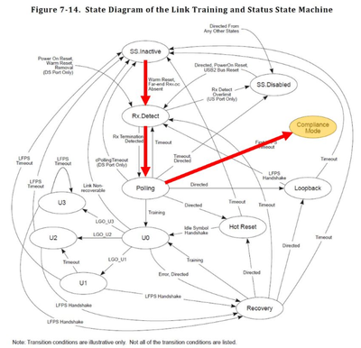

Hi all,
We are developing a USB host device running Linux OS on iMX8QuadMax.
This device supports USB 2.0 High Speed and USB 3.0 SuperSpeed (it is a host device).
I want to test compliance tests to verify electrical characteristics. However, these tests require a test signal.
For USB2.0 Hi-speed
4 test modes are required for testing.
Does your Linux include EHSETT by default?  If so, how is it called and used?
If your Linux does not include it, do you know of any source code similar to EHSETT?
I don't care if it's code by an outside open communitiy, please let me know.
For USB3.0 Super Speed
Does your i.mx8qm automatically transition to compliance mode?
If the transition were automatic, we would have nothing to do.
If it does not transition automatically, how do we generate CP0-7 signals? Please let me know the procedure.

1) can use memtool
2) refer to the register as below
Adjust USB3.0 to compliance mode registers--PORTSC1USB3(offset: 1_0490h)
/unit_tests/memtool 0x5b130490=0x0a000340

YukioOyama
Hi joanxie-san,
Thanks for your reply.
You guided me through the register settings, doesn't that mean it automatically transitions to compliance mode?
Yukio Oyama
2,437件の閲覧回数
joanxie
yes, I think so, you can use memtool to read this register to double check if bsp set to the compliance mode or not as default
2,433件の閲覧回数
YukioOyama
Hi joanxie -san,
Thanks for the quick reply.
I understood about the possibility of not transitioning automatically .
I can understand your suggestion to check the default behavior of the device to find out. However, I will take that test at an outside testing house. (because the measuring equipment to test it is very expensive and not available to us)
I will consider trying it pseudo.
It looks like I can make the transition to compliance mode with a 50 ohm termination and no response to LFPS.
I will open a new case if new questions arise. I'll close this case. Thanks.
