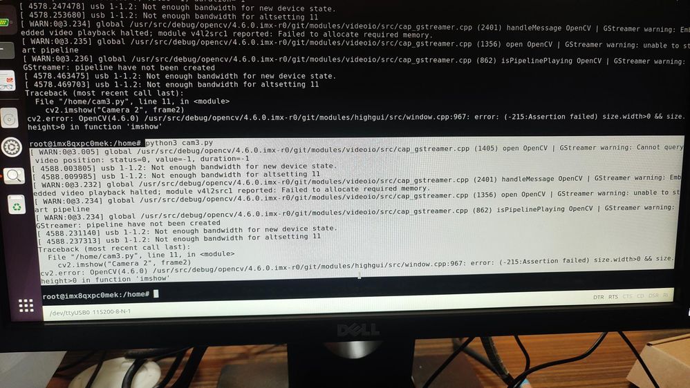

We are trying to test dual USB camera with imx8qxp board where we could test successfully with gstreamer when we connect to 2 different usb ports whereas when we connect the cameras via external hub it fails even though one camera at a time still works but not both cameras at a time
We tried to externally power the HUB as well without any luck. Any pointers would be helpful to move forward

hi, i'm can't able to open dual usb camera at same time but it is working well for single usb camera .i have connected these usb camera through usb hub 3.0
This is the code i run in terminal

it shows following error message that :
1. not enough bandwidth for new state
2. not enough bandwidth for altsetting 11.
3. gstreamer warning : embedded video playback halted  ; module v4l2src1  reported : Failed to allocate required memory.
4. gstreamer warning : unable to start pipeline
and  i have attached pic for your reference . please guide me how to connect dual usb camera at same time in imx8pic.jpg

Many if not the most of USB cameras on the market are broken like this. Analyzing USB descriptor, which can be read using MS USB Device Viewer from MS SDK (usbview.exe), usually cameras reserve much more bandwidth than is necessary to send their video stream. Everything works well with single camera, or two such cameras connected to different USB host controllers, but one of them fails when both are connected via hubs to the same USB host controller. Windows/Linux checks if there's available bandwidth to grant bandwidth request. It won't play if not enough bandwidth.
Is it high speed camera? For isochronous transfer your pr_dwMaxPayloadTransferSize, see probe/commit stuff, for single camera can be as high as 3072. Thats 3 microframes, 1024 bytes each, 8kHz rate, which turns to (3072-12/*header*/) * 8000Hz ~24MB per second. 2nd camera with the same pr_dwMaxPayloadTransferSize=3072 won't fit. Reserved bandwidth + overhead and there's no space for two cameras with pr_dwMaxPayloadTransferSize = 3072. For two cameras your pr_dwMaxPayloadTransferSize should be no more than 2517. For 3 - 2048, 4- 1600. These are experimental numbers, perhaps with different OS they can be little lower or higher, but they worked for me. To use more cameras I was reducing frame rate and probe/committing to different frame interval and max payload size, for each there should be corresponding interface descriptor with right endpoint descriptor for max payload of 3072, 2517, and so on. That all was used with uncompressed video. Compressed should be simpler, just don't reserve more bandwidth than is really required, think about other devices user may need to connect to the same HUB tree.

Perhaps it was bit unclear, but if camera requests a lot of bandwidth, you can fix it either 1) fixing camera firmware or 2) look for camera, which doesn't request so lot bandwidth.
Windows 7 allowed to check used bandwidth. If you can plug you camera to Windows 7 PC, look in Device Manager, root hub properties if I recall, it should show bandwidth used. Of course you should check it while video is on.
Using usbview.exe on Windows you may look deeper for what to expect from you camera. Perhaps Linux lsusb -vvv can help as well, I just haven't tried it myself. Look for Endpoint descriptors. There could be one or more isochronous transfer descriptors like this

  • 1. not enough bandwidth for new state
  • 2. not enough bandwidth for altsetting 11.
This should exactly mean that video frame size and frame rate lead to choosing endpoint descriptor, which leaves no spare bandwidth for another camera. If you are using USB SS camera and USB 3.0 HUB, then you should have no problems, provided host and device operate in SS mode instead of HS mode.
In HS mode you easily can reach bandiwth limitation, especially if camera doesn't care about other USB devices on the same USB bus and takes maximum available BW via wMaxPacketSize of 3x 1024 bytes. Can you show `lsusb -v` output? No picture please, text. Doesn't you camera provide lower frame size or frame rate format? If available, try choosing lower resolution and or frame rate.

Thanks a lot  bro !.. as you said i have reduced my frame and tried with that its successfully working by python code.
