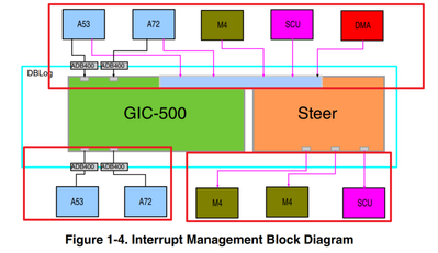

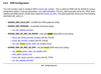

We are trying to put all cores(A53) to suspend and DDR to self refresh mode, so my question in once we put all cores to suspend mode by sending command to SCFW, how to drive DDR to self-refresh mode, can we do same from SCFW or any other approach.
And since A53 is in suspend, how to resume to normal on GIC.
3,257 Views
Zhiming_Liu
Interrupts from each subsystem are mapped on both GIC and interrupt steer and have the
same index starting at 32.
Interrupt Steer is used to route interrupts to the two M4 subsystems and the SCU. GIC500 is used to route interrupts to A53 and A72
--> Please refer these API in  sc_fw_port.pdf
-> You can refer imx_domain_suspend_finish function
