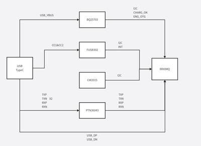

How should I solve this problem?
My system framework is shown in the following figure:

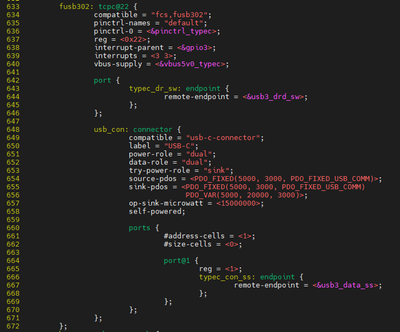

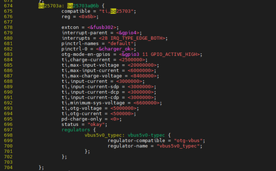

my dts config as follow:
bq25703:
cw2015:
fusb302:
