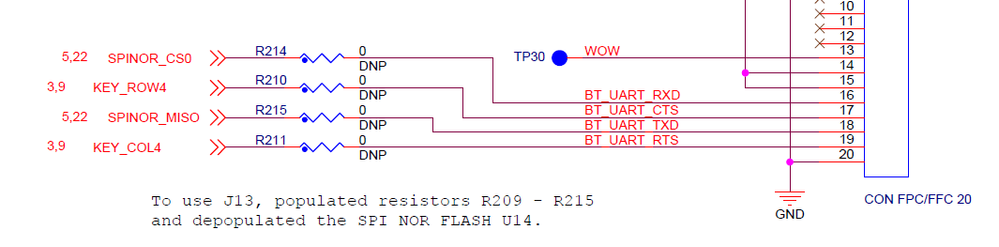

Hello All ,
I am using sabresd-6q freescale board .
I have integrated Broadcom Bluetooth chip over UART interface .
RX/TX lines are working , as its confirmed using loop-back test in HW .
CTS/RTS lines are not working.
As bluetooth vendor firmware works with flow control , there is must for handshaking to happen between host and controller.
Can any one clarify , whether the UART protocol is tested on sabresd board .?
Is there any dependency in S/W , so as to enable / make CTS/RTC lines work?
I carried out serialAndroidTest , Basically testing the working of CTS/RTS lines on sabresd-6q board , the test is failing .
Can any one help , how to debug this RTS/CTS issue ?

Hello,shivanagouda,
    If you are using UART for bluetooth of sabresd-6q board, you will have to adjust hardware and bootargs in u-boot. see following schematic:
(1) Adjusting hardware
R214,R210,R215 and R211 should be populated. UART5 is used here, mapping to CPU pins:
KEY_ROW1--->BT_UART_RXD
KEY_ROW4--->BT_UART_CTS
KEY_COL1--->BT_UART_TXD
KEY_COL4--->BT_UART_RTS
(2) Using "bluetooth" in bootargs of u-boot .
open "myandroid/kernel_imx/arch/arm/mach-mx6/board-mx6q_sabresd.c", and we will see these lines:
static iomux_v3_cfg_t mx6dl_uart5_pads[] = {
MX6DL_PAD_KEY_ROW1__UART5_RXD,
MX6DL_PAD_KEY_COL1__UART5_TXD,
MX6DL_PAD_KEY_COL4__UART5_RTS,
MX6DL_PAD_KEY_ROW4__UART5_CTS,
/* gpio for reset */
MX6DL_PAD_GPIO_2__GPIO_1_2,
static int __init uart5_setup(char * __unused)
uart5_enabled = 1;
return 1;
__setup("bluetooth", uart5_setup);
Please try above steps !
