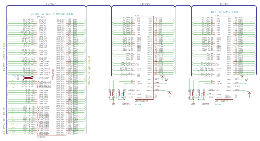

Hello everyone,
slowly I'm running mad with this:
I have a new custom board with i.MX6DL connected to two RAM-Chips:
I created the U-Boot RAM-cfg with the LPDDR2-Script-Aid-v0.06. (See attached *.cfg-File and Script-Aid-XLS).
I tested several RAM-definitions in the U-Boot Header-File: (CFG-File and Header-File both with Interleaving and Non-Interleaving-RAM). The fat text seem to work with an i.MX6Quad.

Every Test ends in the same result: Linux boots, but when I run <memtester> the whole System freezes including a Heartbeat-LED.
Somewhere I do something terribly wrong, but where? Why does it work with the Quad-Core but not with DualLite?
I think I don't understand CS0_END-Parameter! (And some other things, too.)
PLEAAAAAAAASE HELP!!
I can provide more Information if this helps.

igorpadykov
Hi Steffen
was board able to pass latest ddr test
i.MX6/7 DDR Stress Test Tool V3.00
"memtester" issues may point to power supplies problems, like
instabilities, ripples, so may be recommended to check them using
IMX6DQ6SDLHDG, Hardware Development Guide for i.MX 6Quad, 6Dual, 6DualLite, 6Solo Families of Applic...
igor
