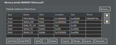

I'm trying to move the IVT to RAM in order to have an increase with the performances. Looking at several threads in the forum, I didn't find a guide for that. So what I did is:
  1. Partition a RAM block from ITCM called SRAM_ITC_IVT that can contain the vector tableNuova immagine bitmap.bmp
  2. Using managed linker script to configure memory RAM_ITC_IVT as a KEEP(*(.isr_vector))Nuova immagine bitmap (2).bmp
  3. Copy the vector table from rom to ram and change the location pointed by SCB->VTOR

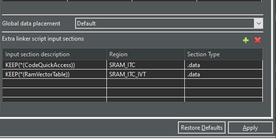

After modyfing the Managed Linker Script as follow:
And the code as:
#define TABLE_SIZE	173
uint32_t __attribute__((section("RamVectorTable"))) __attribute__((aligned(512))) ramVector[TABLE_SIZE];
 * @brief Main function
int main(void)
    __disable_irq();
    memcpy(ramVector, (uint32_t*)SCB->VTOR, sizeof(uint32_t) * TABLE_SIZE);
    SCB->VTOR = (uint32_t)ramVector;
    __enable_irq();
    /* Init board hardware. */
    BOARD_ConfigMPU();
    BOARD_InitPins();
    BOARD_InitBootClocks();
 I could allocate the vector in the right section (0-0x300) at address 0x0. However I didn't see any changes concerning the processor performance..
