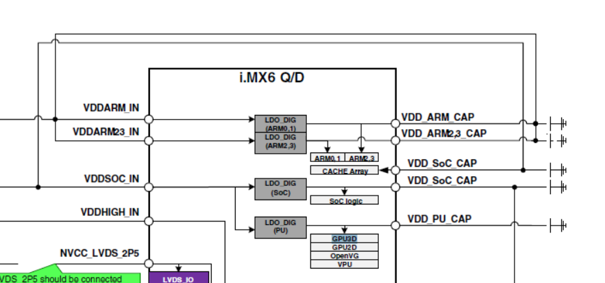

How is it possible to work only 2D GPU ? If it is a power supply problem for GPU section the whole GPU shouldn't work. But here it just function 2D GPU and 3D GPU is not functioning.
Whole the GPU section power up from VDD_PU_CAP internal regulator. In imx6q data sheet it is recommended to have 1.2V in VDD_PU_CAP. When I measure the voltage while the board is functioning it shows 1.12V. I doubt that. Is this the reason for this GPU hang when I'm using 3D GPU ? Any possibility with this low voltage for GPU hang ?
Regards.
Peter.

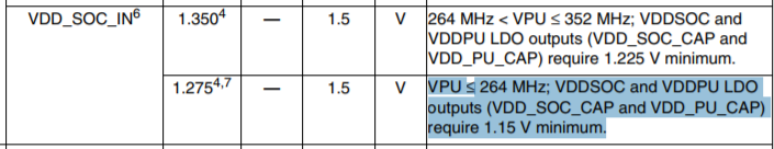

igorpadykov
Hi Peter
yes VDD_PU_CAP (and probably associated with it VDD_SOC_IN) bad power supplies may
cause GPU hang, please check Table 6. Operating Ranges i.MX6DQ Datasheet
http://cache.freescale.com/files/32bit/doc/data_sheet/IMX6DQCEC.pdf
To check that, one can slightly increase VDD_PU_CAP or add additional capacitors and test if it hangs.

3) Following you can see VDD_PU_CAP means LDO_PU regulator output and that will be GPU power in. Am I correct ? When I measure VDD_PU_CAP in my custom design it is 1.1V. Is this correct ? Can you explain following diagram which related to GPU power section ?
4) When I check the REG1_TARG register values in my custom board LDO_PU is in bypassed mood. Then from where the GPUs get power ?
Peter.

igorpadykov
Hi Peter
REG1_TARG in bypassed mode means VDDSOC_IN is directly passed to VDD_PU_CAP
without regulation. To be able to set REG1_TARG it is necessary to use "ldo-on"
mode (not bypassed), files with "ldo" suffix like zImage-imx6q-sabresd-ldo.dtb e.t.c.
Still you can slightly increase "fsl,soc-operating-points" settings to test if it will
improve stability. Use Table 6 Operating Ranges i.MX6DQ Datasheet
>3)  ...
correct
igor
