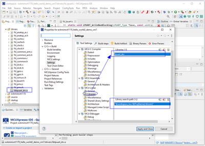

Due to project development requirements, additional C++ static libraries were added to the RT1170 SDK for use. The current one is MCUXpresso IDE V11.5.1_726.
1,538 Views
jay_heng
Note that you need to set Library search path and name in MCUX project option after adding file into project folder
1,545 Views
jingpan
Hi @jianwuQuan ,
Yes, can add c++ library to a c++ project in MCUXpresso IDE. And it's no problem on RT1170 EVK.
Please refer to chapter 16 in MCUXpresso_UDE_User_Guide.pdf which can be found in IDE's folder.
