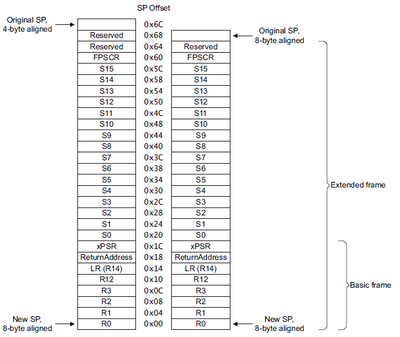

I need help figuring out how to record the current state of the processor registers so they can later be restored at the specific location in code. This will act like a warm reset but starting after initializing all my devices. Below are the functions used on the ARM9 processor. I need to do the same with the Cortext M7 processor. I am using Keilv5 with RTX5 RTOS in my project. Any examples or tips would be appreciated.
Will I also need to clear the stack?

1,141 Views
jeremyzhou
1) Will I also need to clear the stack?
-- No, I'm afraid not. Regarding the Cortex-M core-based MCU, the compiler can manage the stack during the function context operation via utilizing the registers in the cores (as below shows). When the MCU runs the RTOS which provides the stack management for the created task, in addition to the above stack management.

kamal1
Hi @jeremyzhou,
Thank you for the helpful information. Are there any examples of saving and restoring the stack pointer and all the registers?
1,131 Views
jeremyzhou
Thanks for your reply.
1) Are there any examples of saving and restoring the stack pointer and all the registers?
-- No, however, you can learn stack management via reviewing the assembly code of the related C language code function.
