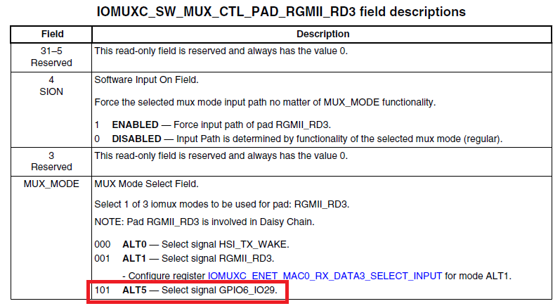

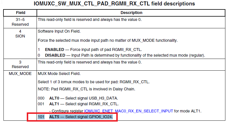

Hi FSL engineer,
I want the pins RGMII_RX_CTL and RGMII_RD3 work as GPIO(output only). And the other signals for these pins were commented. Finally the pin cannot out '1' signal and always keep low. But I replace the pins with GPIO_7 and GPIO_8. It works normally.
I checked the RM and cannot find the difference between these two pairs of pins when configured as GPIO. Could you please advise me how to fix this issue? Thank you.
SoC:i.MX 6QP, OS: M6.0
MX6QDL_PAD_RGMII_RX_CTL__GPIO6_IO24  0x00013030
MX6QDL_PAD_RGMII_RD3__GPIO6_IO29     0x0001B030
usb2553-enctlgpio = <&gpio6 24 0>;
usbfault-enctlgpio= <&gpio6 29 0>;

Hi Igor,
Pins RGMII_RX_CTL and RGMII_RD3 don't connect to 8031.  I want configure them to ALT5 and ALT5. Please refer to the pictures below. As i mentioned, the pins GPIO_7 and GPIO_8 are OK. But i cannot find the root cause. Anything else i should care about?

igorpadykov
Hi Shawn
please attach jtag debugger and try to set outputs of these pads using jtag.
igor

igorpadykov
Hi Shawn
is there some rgmii circuit on the board, as for example on i.MX6QP Sabre SD schematic SPF-28857
these two signals are connected to outputs of AR8031 (U516) RGMII_RXD3, RGMII_RXDV.
In general one can attach jtag and check iomux settings and try manually set them to '1' signal.
