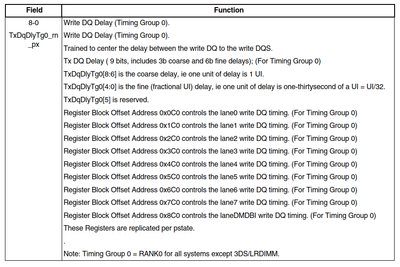

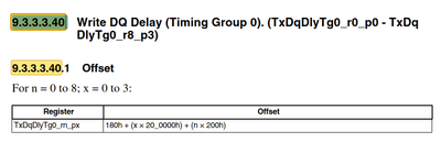

In one of our design we are making small adjustments to the DDR data lines and are trying to determine if our software also needs to be updated to account for these changes. In combing through the reference manual I found several registers referring to the read/write delay of the DQ lines. However these registers have an offset formula that goes with them that I don't fully understand.
What do X and N refer too? I first thought that N was referring to the eight data lines this register seems to control, but the fields section list a different offset for the data lines.
Also what are the timing groups 0 through 3? The reference manual doesn't seem to define what these are.

 X = 0 to 3, means 1Byte to 4Byte. n = 0 to 8 means 8 DQ lines of one Byte.
And i think timing groups have same explain with X.
