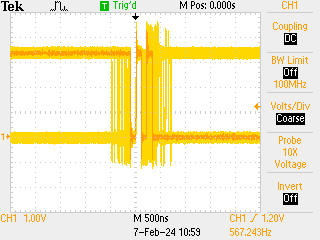

I'm on the way to make it usable for my tasks. On not very fast Vybrid FIQ interrupt latency seems being shorter than it takes to clear PIT timer interrupt request, so 4 instructions FIQ handler reenters several times to toggle pin and clear PIT interrupt flag. Infinite persistence waveform looks like this with Linux running.
Last attempts to enable GIC interrupt grouping (and FIQ) in LInux kernel seem being made ~10 years ago. I mean suggested patches for irq-gic.c, which were never adopted.
