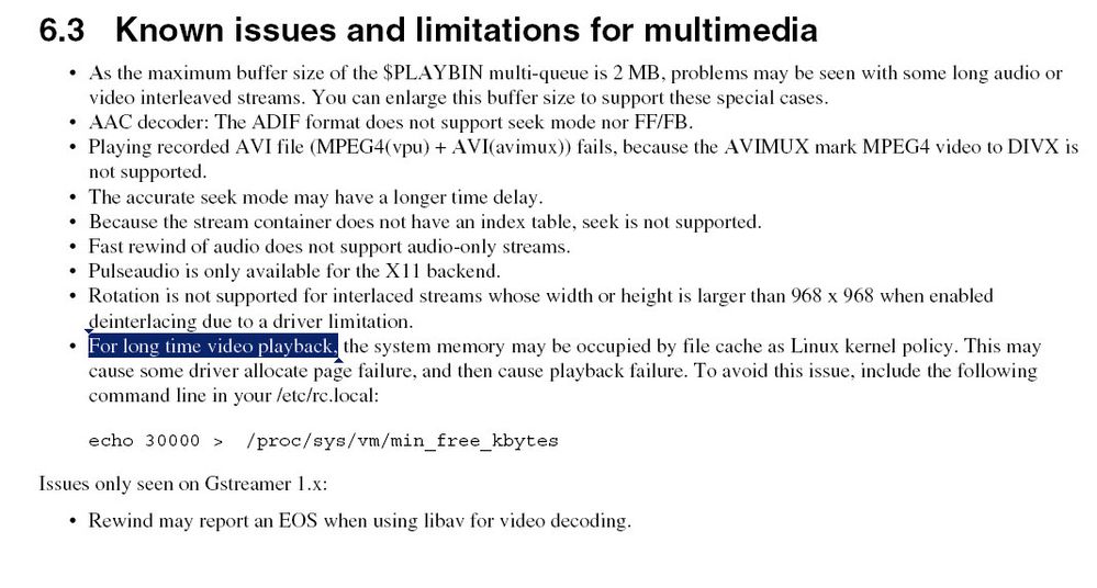

We have an issue about gstreamer error while playing video in the long time.
Use this command to play video:
gst-launch filesrc location=[Video Path] typefind=true ! aiurdemux name=demux demux. ! queue max-size-buffers=0 max-size-time=0 ! vpudec ! mfw_v4lsink demux. ! queue max-size-buffers=0 max-size-time=0 ! beepdec ! autoaudiosink
Error Messages:
(gst-launch-0.10:6662): GLib-GObject-CRITICAL **: g_object_ref: assertion `object->ref_count > 0' failed
(gst-launch-0.10:6662): GStreamer-CRITICAL **: gst_object_unref: assertion `((GObject *) object)->ref_count > 0' failed
New clock: GstSystemClock
[1;32m[--->FINALIZE aiurdemux
[0m
(gst-launch-0.10:6662): GLib-GObject-CRITICAL **: g_object_ref: assertion `G_IS_OBJECT (object)' failed
(gst-launch-0.10:6662): GLib-GObject-WARNING **: invalid unclassed pointer in cast to `GstAiurDemux'
Can you provide any advice about this issue?

Hi charles
reason may be as described in sect.6.3 Known issues and limitations for multimedia
i.MX_Linux_Release_Notes.pdf from L3.14.28_1.0.0_LINUX_DOCS
