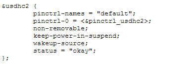

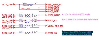

igorpadykov
Hi Jupiter
if 1.8V/ 3.3V switching is not needed one can try to follow SPF-29364 p.10 (i.MX6ULL EVK)
recommendation
and use dts usdhc2 example
https://source.codeaurora.org/external/imx/linux-imx/tree/arch/arm/boot/dts/imx6ul-14x14-evk.dtsi?h=...
igor

jupiter_hce
Hi igor,
Thanks for your response. the usdhc2 in my imx6ul-14x14-evk.dtsi has a statement no-1-8-v;, should I add the 1-8-v or no-1-8-v; to my dts usdhc1?
BTW, how can I delete reg_sd1_vmmc in imx6ul-14x14-evk.dtsi presented in my dts?
