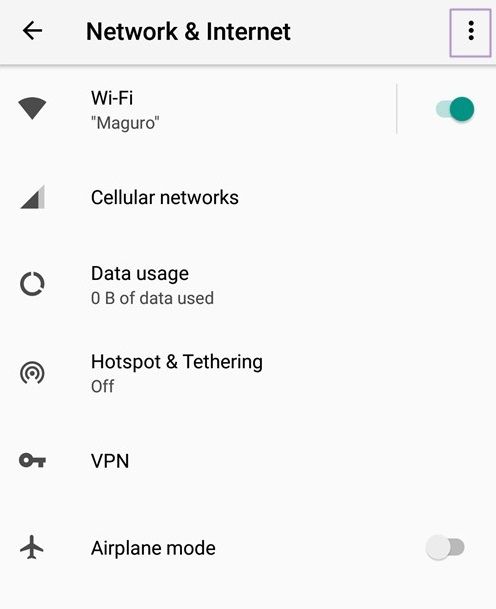

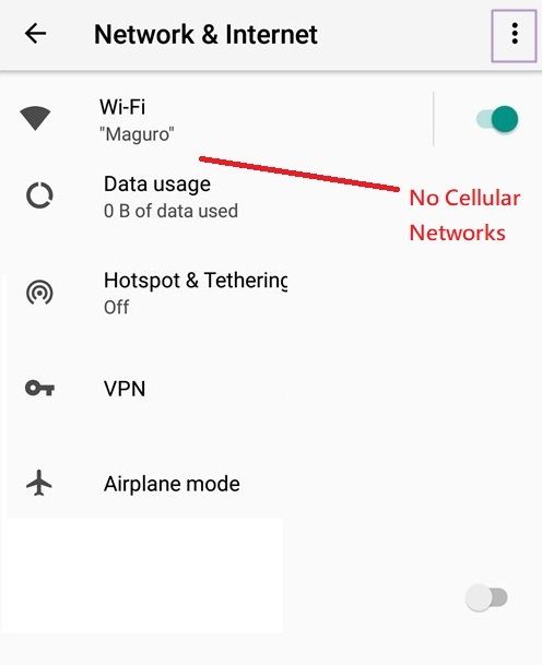

I am porting Android 8.0 on imx6dl with sabresd BSP provided by NXP.
Recently, I am porting USB 4G  LTE driver(Quectel) , however, I met a problem/issue related to UI.
Based on my existing experiences, the mobile network/Cellular (4G) setting page should be available at sub-page under Network & Internet no matter 3G/4G/LTE module is attached or not. However, I did not found that setting page.
Did anybody tell me how to make the setting available?
My UI
The UI is supposed to be as follows:

Based on the information from this post Android8.1 BSP can't find mobile phone data network settings
I think I solved my problems.
My actions is as follows:
    • Comment out the followings configurations on name @device/fsl/sabresd_6de/overlay/frameworks/base/core/res/res/values/config.xml
      • networkAttributes
      • radioAttributes
  1. Modify ro.radio.noril=no @device/fsl/imx6/imx6.mk
