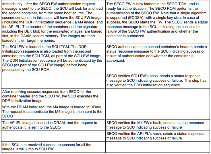

Thank you for your interest in NXP Semiconductor products,
This is the theory behind that operation.
And this is how SCFW creates the partition for M4 image.

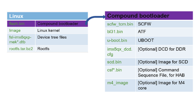

Could you give little more brief in terms of flow , once we flash "flash.bin" on target board
How it will start the sequence how it loads other images
We are completely stuck at some point with out any clue
From pic I have attached , its high level diagram but we need some more details info related how exactly it fetches the ATF-> U-boot->

All the loading is done by the SCU ROM and once it is done it
jumps to the SCFW which has no ability to load anything further. The ROM does not start any of the CPUs.
