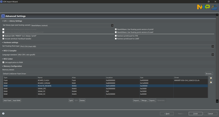

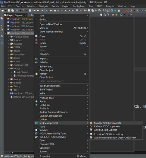

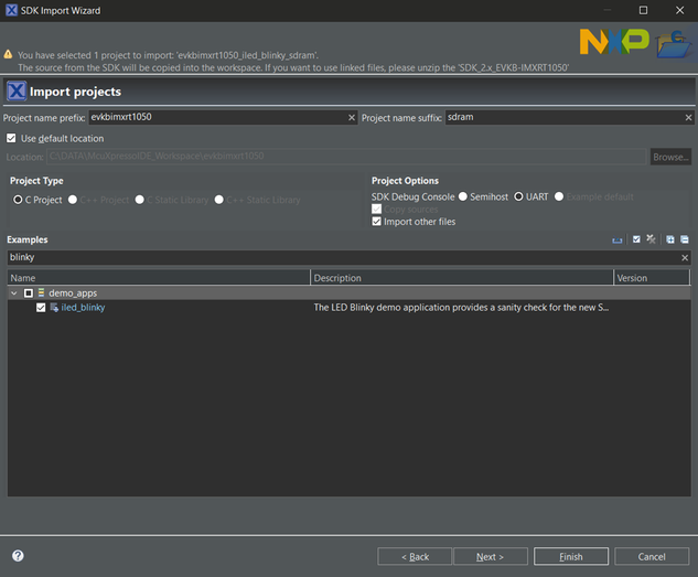

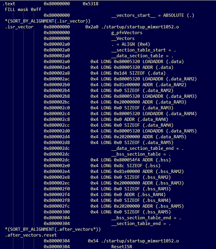

I picked evkbimxrt1050_iled_blinky demo application as starting point:

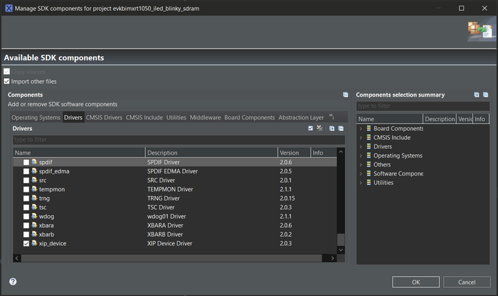

Because this project is configured by default to run using eXecution In-Place (XIP), while importing I immediately checked "Link application to RAM" and moved BOARD_SDRAM as the first RAM area listed in Memory Configuration. These two operations should be sufficient to instruct MCU Linker to move all the code in external SDRAM starting from 0x80000000 address.
I also moved NCACHE_REGION right after BOARD_SDRAM to have all the external SDRAM contiguous in memory configuration, thinking (and hoping) this will not affect MCU Linker in any way.

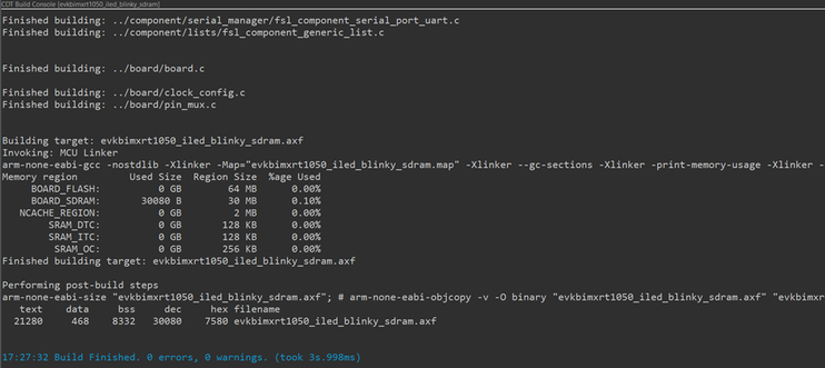

After SDK sample project import completes, if I build the project this is what I see in build console output and MAP file:
What I see in above listings makes me think I am right, but please... again... correct me if NOT.

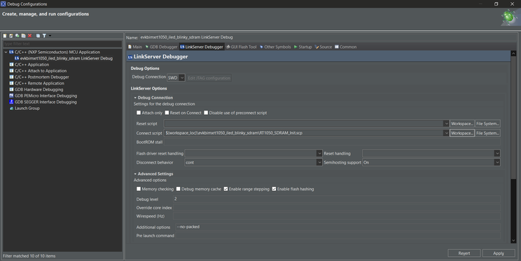

Then, thanks to this article in NXP community blog I figured out that LinkServer needed a "customized" Connect Script to initialize the Smart External Memory Controller (SEMC) to enable the SDRAM, and consequenly to program and jump to 0x80000000 successfully. The connection script for RT1050 SDRAM initialization is provided at above link, and when added in Debug Configuration something starts to work.

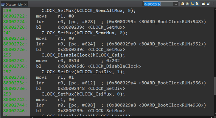

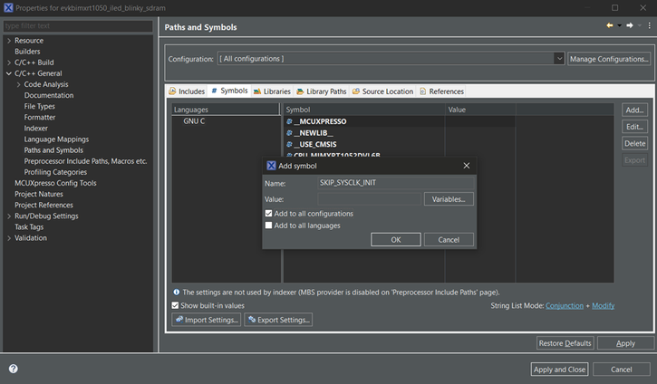

Loading to SDRAM now works, but if I press Resume (F8) then a crash immediately occurs:

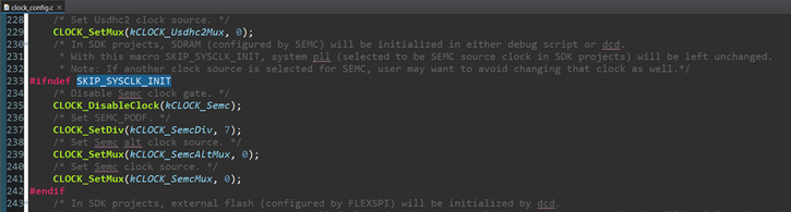

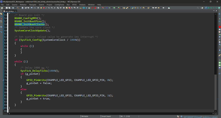

The Hard Fault seems to be triggered by BOARD_InitBootClocks(), when SEMC clock configuration is performed. Then I said to myself: "Ok, right. If LinkServer already configured SEMC to support external SDRAM and instruction are fetched from there, it's natural that changing clocks configuration while fetching instructions may cause some malfunctioning. Let's define SKIP_SYSCLK_INIT symbol.

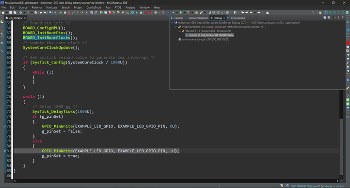

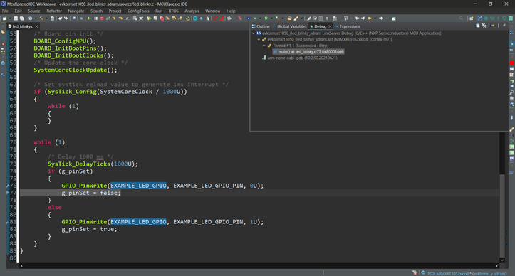

Now, if I start debugging and just press Resume (F8) the program runs and LED starts to blink.
HURRAY! No... wait.... I cannot set breakpoints..... or better, I can set breakpoints, but they'll be never hitted. As you can see in the screenshot below, program is running, breakpoint is set, but no triggering.
The only way to have a breakpoint triggered is to set it up using right mouse button --> Add breakpoint... --> Type: Hardware
HURRAY! Now the breakpoint is working! No... wait.... if I try to step....... it's resuming execution, then stopping when hitting the same breakpoint again...........

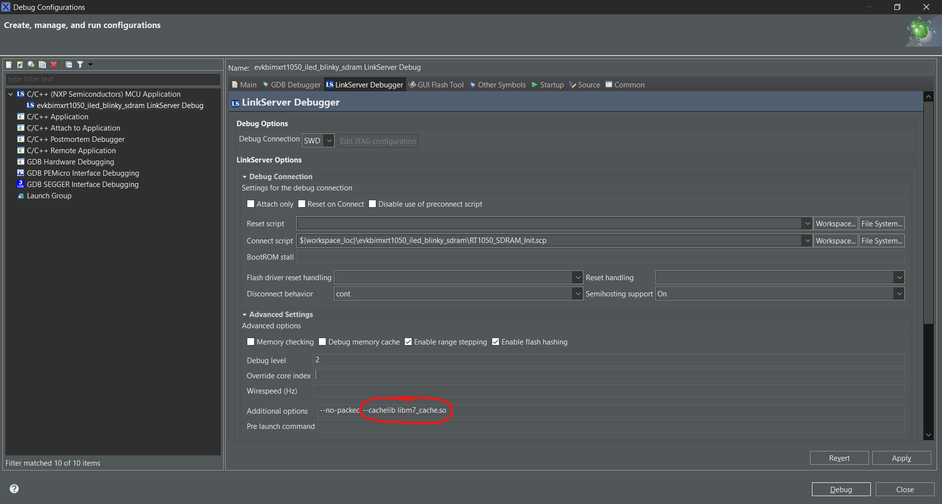

So, debugging was impossible... until I found this thread in NXP forum in which @kerryzhou hinted at --cachelib libm7_cache.so LinkServer option, which I later found also explained in RT1050_BriefOverview_v201.pdf document provided at the same first link providing the connection script too. The document says (let me replace the screenshot, just to make it less outdated):
Debug performance and the Data Cache
When debugging images that make use of SDRAM or OC_RAM for storage of variable data (globals, stack, heap etc.) then the following option should be set within the LinkServer debug launch configuraton as shown below:
This module ensures that debug cache coherence is maintained, and correct debug operations may fail if this module is not specified. However there will be a debug performance penalty when this module is used.
Note: this module is not required io the SDRAM (or OC_TAX) only contains constant or uncached data.
HURRAY! Load works! Execute works! Breakpoints are triggering! Stepping works!
The only drawback is that stepping through the code is reaaaally, really slow.

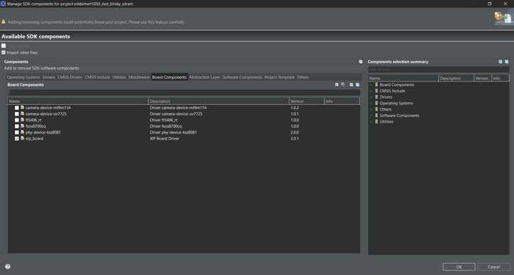

As a very last step, I removed xip_device and xip_board from SDK components, which are no more necessary because now the project is no more executing code in-place from FLASH memory, and I also set XIP_BOOT_HEADER_ENABLE symbol to 0 in both Debug and Release configurations because, for the same reason, I don't need XIP boot header to be included in generated image anymore.

Good post. Also take a look at sections 18.8.5 and 20.6 in the User Guide.
I think reordering of memory regions is not necessary when enabling "Link Application to RAM" is used. However, "soft" reset is kind of a must - the IDE must set PC/SP after downloading the app in RAM.
You mentioned something about the need to force HW breakpoints. If that's what you want, you can instruct GDB to always use HW breakpoints (limited number though) by marking a memory region as read-only - see [1].
If you want to write the app to a different address, you'll have to make sure a bin (at a given address) is written, not an AXF/ELF (that has all the sections/addresses information). See section 15.2 from User Guide.
Also, in one of the previous posts you asked about debugging a relocated app (from flash to RAM). If my understanding is correct, you build/link your app to flash addresses but you still want to be able to debug it once it gets relocated to RAM (using the original ELF from the IDE). This might not be easy to accomplish. I'd say you first need to make sure the IDE does an "attach" to the target running the app in RAM, instead of the regular flash/RAM download. Then, you'll have to make GDB (re)load the ELF file at the actual (execution) addresses - see [2]. In other words, you'll have to reload debug symbols at address 0xABC0 (assuming this is the base address for text at execution time in RAM) instead of 0xFED0 (assuming this is the address for flash execution).
