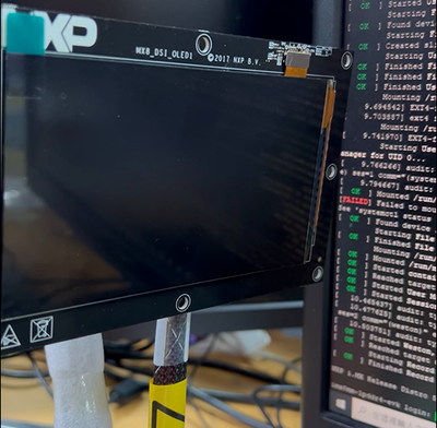

Laiweiyu
Log in attach file
setenv fdtfile imx8mm-evk-rm67199.dtb
The panel shows shortly "LINUX penguin" ,and then can't display anymore
if necessary,I can use camera record
2,116 Views

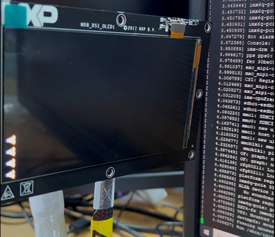

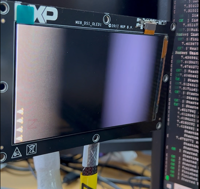

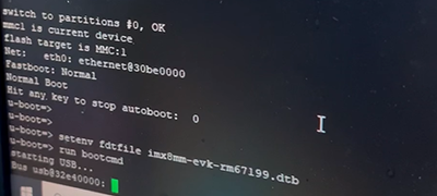

Laiweiyu

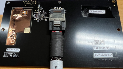

I already use " imx8mm-evk-rm67199.dtb" , but it can't display,
And I only have I.MX 8M Mini LPDDR4 EVK board & MX8-DSI-OLED1A panel
I take some pictures show this issue
2,100 Views

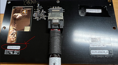

Zhiming_Liu
Hi @Laiweiyu
Checked the panel part number in my side, it's same as yours(SCH-29834_A).
You need saveenv after you setenv.
2,095 Views
Laiweiyu
I tried,but this dtb still can't display,
maybe the reason is that yours panel is MX8-DSI-OLED1,my panel is MX8-DSI-OLED1A ?
2,092 Views
Zhiming_Liu
We are using same panel:
You can contact NXP to return this panel as it maybe a quality issue.
2,001 Views

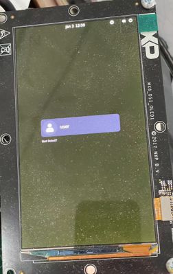

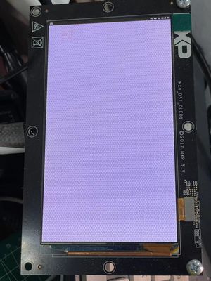

Laiweiyu
OK, I return this panel and get new panel,
and I use newest version image(L5.15.71_2.2.0_MX8MM).
It can display when set "imx8mm-evk-rm67199.dtb"
