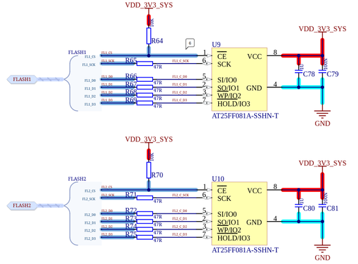

A schematic of the memory below.
6,555 Views

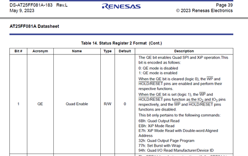

Does that mean that the flash is not working in Quad mode?
My question now is how to ensure Flash is working in Quad mode, and how to generate a working FCB from the RAM image, it this is possible.
6,532 Views
Kan_Li
Hi @tbonkers ,
It is an expected result since you are using single wire flash with RT, please update LUT to single wire mode and try again.

I am not sure how to do this. Can you point me to a resource which shows how to initialize Flash in Quad mode, and be able to upload code to Flash?
My previous post referred to flashing the code example into RAM.
6,473 Views
Kan_Li
Hi @tbonkers ,
please kindly refer to the data sheet of the qspi flash for details.https://www.renesas.com/us/en/products/memory-logic/non-volatile-memory/spi-nor-flash/at25ff081a-8mb...
