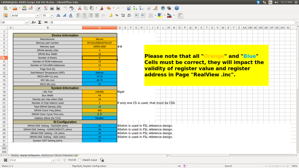

I followed the I.MX6DQSDL DDR3 Script Aid V0.10 document. In this document I entered the Values as per our DDR part number MT41K256M16TW-107 from Micron.calibration.png
  • But When we are going to start the DDr calibration its showing "DCD ADDRESS OUT OF RANGE"

aravinthkumarja
Senior Contributor II
HI hrushinale​,
After filling the values, you open RealView.inc sheet in same excel sheet. There you will get the updated DDR value.
Then this value you need to update in you ddr application .inc file.
Then you try.
If again it shows error, Can you mention what steps you followed??
Aravinth
4,010 Views
hrushinale
Hello aravinth,
I followed the same steps:
1) First I enter the Values in Excel sheet as per our DDR Part number.
2)then updated the values I got to .inc file
3) Then start the DDr calibration
but still Its giving the same error
