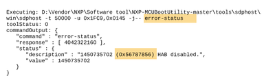

sdphost -u 0x1FC9,0x0135 -j -- error-status
   "command": "error-status",
   "response": [
      858993459
   "status": {
      "description": "1450735702 (0x56787856) Hab Is Disabled (Unlocked)",
      "value": 1450735702
sdphost succeeded, HAB disabled

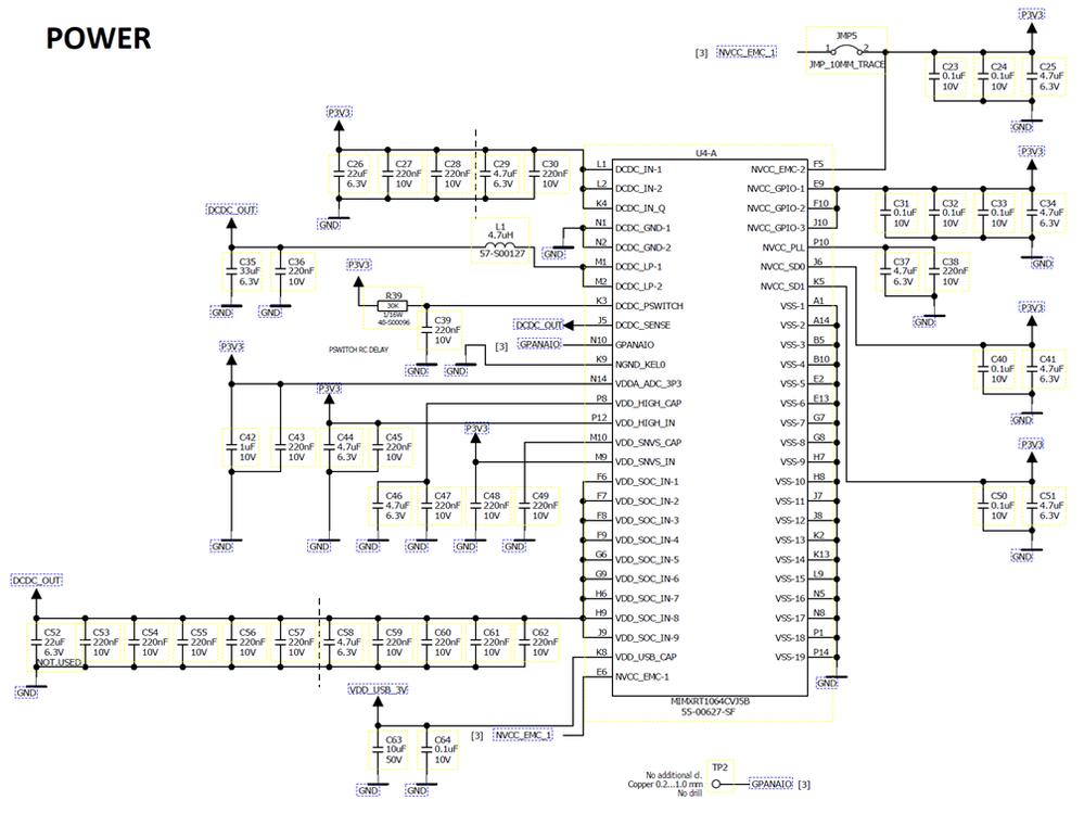

Hi @mike_asm
Thank you for your reply!
I only saw that you are missing a capacitor, and suggested doing a little re-work to add the external 32 KHz cristal. Also a 32 KHz signal could be added, that mentioned as bypass mode in the RM. I am not sure if that will have an impact to solve the issue but it is convenient to test to narrow down.
https://community.nxp.com/t5/i-MX-Processors/IMXRT1064-serial-boot/m-p/1697922/highlight/true#M21015...
Let me know if you have seen anything else.
Diego
21,767 Views

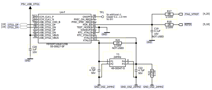

mike_asm
Hi Diego, I think, that is a mistake in your Hardware Development Guide. We have 0,22µF capacitor, like on Evaluation Board. We don't use RTC in this project, therefor 32 KHz cristal is not populated. The same design with IMXRT1170 works without any problem in USB-Boot mode.
Is there some specific things else, have an impact to come in COM-Boot mode instead of USB-Boot mode?
Thank you.
21,757 Views
diego_charles
Hi @mike_asm
The 4.7 uF is  recommended as a bulk capacitor, while the 0.22uF as a decoupling cap. Unfortunately, sometimes the EVK does not  strictly comply the hardware design guide recommendations, as the EVK is designed to be a low-cost development board. I will try to give with more information on this.
Eventougth your application still  does not require the external 32 KHz, like for RTC. I cannot assure that the application  will work properly without the crystal. This is because the external 32 KHz crystal signal (CKIL) can also be used by other peripherals, like WDOG, USB (in the wakeup scenario)
Currently, I do not know the specific reason to explain why your design can not enumerate the USB1 in serial downloader. For now, and before doing any other HW rework/investigation,  the easiest test we could do  is: calling the runBootloader() API.
I can make this work in our RT1064-EVK : the MCU gets into serial downloader mode and USB1 one gets enumerated. We now that the USB demos work on your board, so lets narrow down by invoking the roomBotloader during application execution.

mike_asm
Hi Diego,
we checked and yes, the MCU is in serial downloader mode. How can we switch to USB? What do we have to keep in mind?
We would like to use USB as a virtual COM port later. Thanks

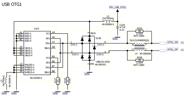

mike_asm
Hi Diego, here is a part of our schematic. Thanks.
21,947 Views
diego_charles
Hi @mike_asm
 Let me make a follow up to the thread. After this time, did you found any other result ?
I saw that you are missing a capacitor for the VDD_SNVS_CAP. You need to have one 22 μ F² and a1 × 4.7 μF capacitor.
I also noted that you are not using the external 32 KHz crystal. Could rework your design to ensure  to have the 32 KHz  signal?   I just want to make sure that it is not affecting the USB serial downloader ennumeration.
Thanks a lot for your patience.
Diego
