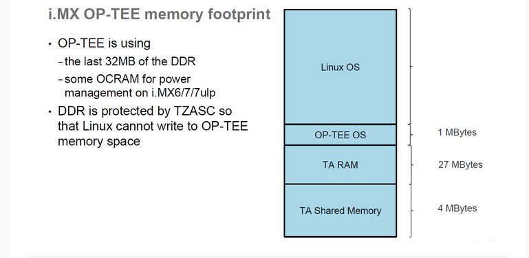

I'm trying to get my board to recognise all my RAM, I had it recognising 128MB but I have 1GB installed. I have used the DDR configuration tool to configure uboot to configure the memory registers and it recognises the full amount of RAM. I can load an image onto the board using UUU, but on a restart I get the message "Starting kernel ..." from uBoot, then a few messages from OP-TEE starting, then the whole system hangs. From booting without my mods, I'd expect to get "Booting Linux on physical CPU 0x0". I have also CFG_DDR_SIZE in OP-TEE to 0x40000000.
What else do I need to configure?

igorpadykov
Hi Nick
one can try to boot without optee, in particular memory size can be adjusted
in uboot with #define PHYS_SDRAM_SIZE
mx6ul_14x14_evk.h\configs\include - uboot-imx - i.MX U-Boot
igor

igorpadykov
Hi Nick
also one can look at similar issue on
Hikey 620: increase TA RAM in OP-TEE · Issue #2313 · OP-TEE/optee_os · GitHub

nicholash
Hi Igor,
I have solved this issue by pulling the latest version of imx-optee-os.
Evidently, this was solved in the last few months.
Thanks for your help.
