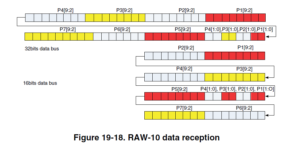

We have an own IMX6QP board communicating with an own CMOS sensor board (Sony IMX290 based) via MIPI interface. We developed a camera driver and also modified some of the NXP BSP files and more or less the solution is working, but we are experiencing a strange behavior apparently related with the vertical sync which we are not able to solve.
Camera streams data correctly (all MIPI_CSI registers indicate correct value) but we are not receiving the start of frame at the correct position.
For debugging purposes, the camera is sending a pattern, fixing all pixels of a cocnrete row to 0x3FF (all FFs with 10 bits) but we never found this pattern at the indicated row but in other rows, changing with each frame It has some kind of  “repetitive” behavior

For 1920*1080 RAW10 input, it is total 2400*1080 bytes.
To received it as 16bpp generic mode, width = 1200 and height = 1080.
Have a nice day!

   See below, please!
The MIPI CSI2 RAW10 data is mapped as followed, so iMX6 CSI should use 16bits generic mode to capture it, the customer should calculate the frame size for IDMAC, if the IDMAC size is not same as real frame data size, scroll issue like the video will happen.
By the way, iMX6 has no hardware ISP to process the RAW video.
Hope above information is helpful for you!

Thanks for your reply. Just to verify if I understand your comments, I specify my scenario in order to cross check register values: Assuming camera is sending a 1920x1080 image 10 bpp (this is 1920x1080x(5/4) bytes), which would be the correct configuration of the following registers?
  • IPU0_CSI0_SENS_CONF: Specially CSI0_DATA_WIDTH & CSI0_SENS_PRTCL
  • IPU0_CSI0_SENS_FRM_SIZE
  • IPU0_CSI0_ACT_FRM_SIZE
And what about CPMEM?
  • BPP
  • FW (Frame width)
  • FH (Frame height)
  • SL (Stride Line)
  • PFS
Thanks for you help!

Thanks Wigros,
Your indications served to solve the issue!
