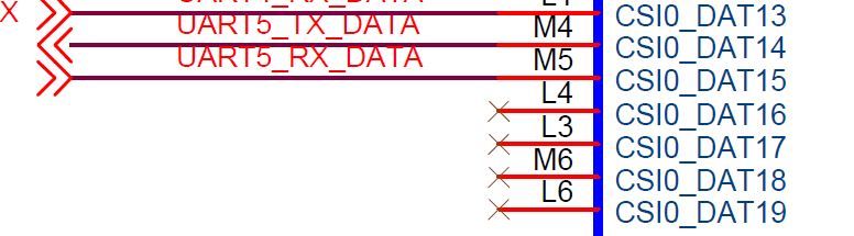

hi,
We have a custom design that utilizes uart5 to a z-wave module and the uart does not receive or transmit any data.
the hardware connection is on
IO-Mux
#define MX6DL_PAD_CSI0_DAT14__UART5_TXD                                        \
  IOMUX_PAD(0x0370, 0x005C, 3, 0x0000, 0, MX6DL_UART_PAD_CTRL)
#define MX6DL_PAD_CSI0_DAT14__UART5_RXD                                        \
  IOMUX_PAD(0x0370, 0x005C, 3, 0x091C, 0, MX6DL_UART_PAD_CTRL)

board-mx6 uart config
static iomux_v3_cfg_t mx6dl_uart5_pads[] = {
  MX6DL_PAD_CSI0_DAT15__UART5_RXD,
  MX6DL_PAD_CSI0_DAT14__UART5_TXD,
static const struct imxuart_platform_data mx6q_sd_uart5_data __initconst = {
  .flags      = IMXUART_HAVE_RTSCTS | IMXUART_USE_DCEDTE | IMXUART_SDMA,
  .dma_req_rx = MX6Q_DMA_REQ_UART5_RX,
  .dma_req_tx = MX6Q_DMA_REQ_UART5_TX,
mxc_iomux_v3_setup_multiple_pads(mx6dl_uart5_pads,
  ARRAY_SIZE(mx6dl_uart5_pads));
  imx6q_add_imx_uart(4, &mx6q_sd_uart5_data);
Any idea on what could be the problem?

Hello John,
     your steps are correct, but by default UART5 is not enabled, so you please check file named "linux top/arch/arm/mach-mx6/board-mx6q_sabresd.c" , and find "static int uart5_enable", then modify it "static int uart5_enable=1;"
Please try to test if your UART5 is OK !
