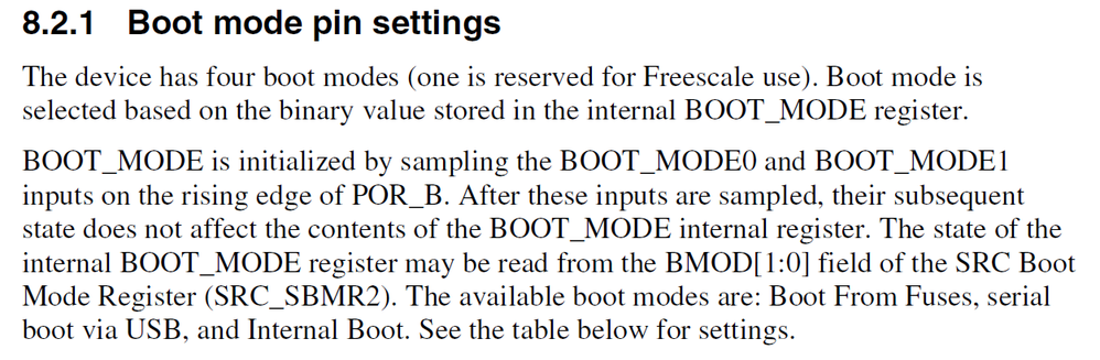

I am working over IMX6 solo processor , as per reference manual  Boot_mode[1:0] should be written 0b10 to select the internal boot. So how to write to write the Boot_Mode[1:0] bits , so processors boot up with Internal boot . Thanks!

as an alternative, you can also set the Boot Mode register by adding pull up and pull down resistors or switches (as it is on our reference boards) to BOOT_MODE0 and BOOT_MODE1 pins.

If you want to configure the Boot_Mode[1:0] register, the register needs to be written by J-tag.
