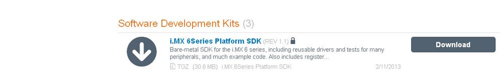

igorpadykov
HI ko-hey
1. yes. For register settings of IPU one can look at SDK ldb example
2. yes understanding is correct and DI's output is connected to LDB input.
Connections can be found in Figure 39-1. LDB Block Diagram
http://cache.freescale.com/files/32bit/doc/ref_manual/IMX6DQRM.pdf
also it may be useful to look at Figure 19-1. i.MX53 LVDS Display Bridge (LDB) Block
http://www.freescale.com/files/32bit/doc/user_guide/MX53UG.pdf
3. LVDS_TXx and LVDS_CLK are produced by LDB block internally, LDB uses
DI's output for its producing
4. all clocks described in IPUx_DI0_GENERAL are produced by IPU internally
for usage with LDB. For code examples one can look at SDK ldb example
