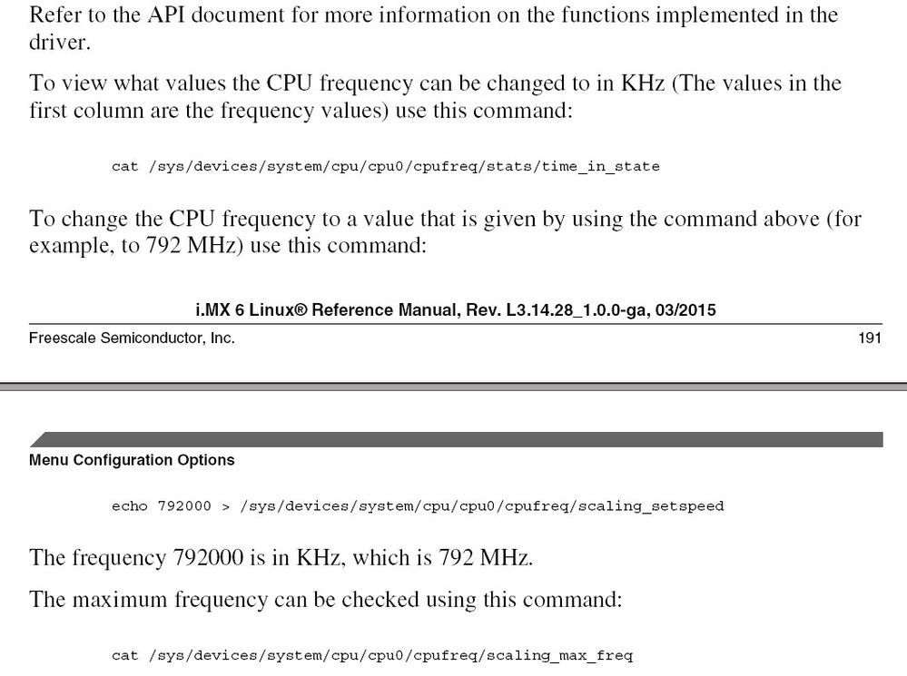

Dear NXP and All,
I am debugging the i.mx6q chip on the Linux 3.14.28, sabresd demo board, I use the default software, Its freq is 792MHz, my chip support 1GHz, so
I want to run the 996MHz, Can anyone give me the steps about the freq change?  Thanks.
I have read the "i.MX_6_Linux_Reference_Manual.pdf", Chapter 24 CPU Frequency Scaling (CPUFREQ) Driver,
but It doesn't say how to change freq?

igorpadykov
Hi Michael
it does show how to change the freq, for example:
echo 792000 > /sys/devices/system/cpu/cpu0/cpufreq/scaling_setspeed
To view what values the CPU frequency can be changed to in KHz (The values in the
first column are the frequency values) use this command:
cat /sys/devices/system/cpu/cpu0/cpufreq/stats/time_in_state
what is full processor part number in the case ?
igor

michael_lee
Dear igor,
Do you check the command which you suggest?
On the Linux 3.14.28, it can't run!
root@imx6qsabresd:/sys/devices/system/cpu/cpu0# ls -l
drwxr-xr-x    4 root     root             0 Jun  3 00:29 cpuidle
-rw-r--r--    1 root     root          4096 Jun  3 00:29 online
drwxr-xr-x    2 root     root             0 Jun  3 00:29 power
lrwxrwxrwx    1 root     root             0 Jan  1  1970 subsystem -> ../../../../bus/cpu
drwxr-xr-x    2 root     root             0 Jun  3 00:29 topology
-rw-r--r--    1 root     root          4096 Jan  1  1970 uevent
there is not the file "cpufreq/stats/time_in_state“
Have you check that?
which part number I use is MCIMX6Q5EYM10AD.
