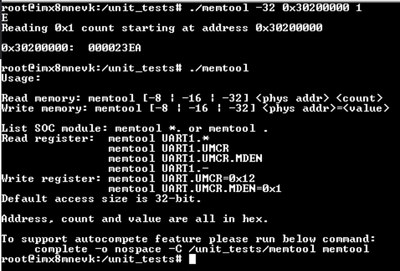

Hi @hhami_2040!
memtool is a tool for reading and writing registers in user space, similar to linux devmem. You can find discussion and usage on this topic in the community.
   https://community.nxp.com/t5/i-MX-Processors/Memtool-access-of-0x020F-address-space-hangs/m-p/398481...
Hope this information is helpful to you.

Chavira
Hi @hhami_2040!
You have to identify the registers that you want to read on the reference manual of your processor, after that you have to use the memtool with the next command:
To read:
./memtool [-8 | -16 | -32] <phys addr> <count>
To write:
./memtool [-8 | -16 | -32] <phys addr>=<value>
[-8,-16,-32] -> is the size of the register you can consult the size of the register in the reference manual.
<phys addr> -> the address of the register that you want to write/read
<count> -> the spaces that you want to read
<value> -> the value to write in the register
https://community.nxp.com/t5/i-MX-Processors/memtool-support-for-i-MX8MM/m-p/1677999

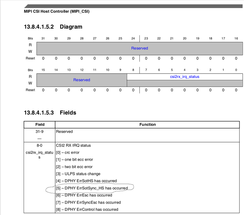

I have an error at IRQ Status Register (CSI2RX_IRQ_STATUS) when log them.
スポイラ
31.065744] mxc_mipi_csi2_reg_dump
[ 31.069206] MIPI CSI2 HC num of lanes[0x100]:0x001
[ 31.074041] MIPI CSI2 HC dis lanes[0x104]:0x00c
[ 31.078633] MIPI CSI2 HC BIT ERR[0x108]:0x000
[ 31.083075] MIPI CSI2 HC IRQ STATUS[0x10c]:0x028
[ 31.087744] MIPI CSI2 HC IRQ MASK[0x110]:0x1ff
[ 31.092228] MIPI CSI2 HC ULPS STATUS[0x114]:0x000
[ 31.097002] MIPI CSI2 HC DPHY ErrSotHS[0x118]:0x000
[ 31.101969] MIPI CSI2 HC DPHY ErrSotSync[0x11c]:0x000
[ 31.107104] MIPI CSI2 HC DPHY ErrEsc[0x120]:0x000
[ 31.112140] MIPI CSI2 HC DPHY ErrSyncEsc[0x124]:0x000
[ 31.117256] MIPI CSI2 HC DPHY ErrControl[0x128]:0x000
[ 31.122334] MIPI CSI2 HC DISABLE_PAYLOAD[0x12c]:0x000
[ 31.127414] MIPI CSI2 HC DISABLE_PAYLOAD[0x130]:0x000
[ 31.132512] MIPI CSI2 HC IGNORE_VC[0x180]:0x000
[ 31.137298] MIPI CSI2 HC VID_VC[0x184]:0x000
[ 31.141680] MIPI CSI2 HC FIFO_SEND_LEVEL[0x188]:0x000
[ 31.146773] MIPI CSI2 HC VID_VSYNC[0x18c]:0x000
[ 31.151378] MIPI CSI2 HC VID_SYNC_FP[0x190]:0x000
[ 31.156144] MIPI CSI2 HC VID_HSYNC[0x194]:0x000
[ 31.160962] MIPI CSI2 HC VID_HSYNC_BP[0x198]:0x000
[ 31.165790] MIPI CSI2 CSR PLM_CTRL[0x000]:0x000
[ 31.170381] MIPI CSI2 CSR PHY_CTRL[0x004]:0x000
[ 31.174944] MIPI CSI2 CSR PHY_Status[0x008]:0x000
[ 31.179671] MIPI CSI2 CSR PHY_Test_Status[0x010]:0x000
[ 31.184870] MIPI CSI2 CSR PHY_Test_Status[0x014]:0x000
[ 31.190038] MIPI CSI2 CSR PHY_Test_Status[0x018]:0x000
[ 31.195199] MIPI CSI2 CSR PHY_Test_Status[0x01c]:0x000
[ 31.200354] MIPI CSI2 CSR PHY_Test_Status[0x020]:0x000
[ 31.205541] MIPI CSI2 CSR VC Interlaced[0x030]:0x000
[ 31.210530] MIPI CSI2 CSR Data Type Dis[0x038]:0x000
[ 31.215597] MIPI CSI2 CSR 420 1st type[0x040]:0x000
[ 31.220532] MIPI CSI2 CSR Ctr_Ck_Rst_Ctr[0x044]:0x000
[ 31.225622] MIPI CSI2 CSR Stream Fencing[0x048]:0x000
[ 31.230709] MIPI CSI2 CSR Stream Fencing[0x04c]:0x000
Based IMX8 TRM document,
0x10C, IRQ Status Register (CSI2RX_IRQ_STATUS) and based CSI Register Debug we have 0x28 value
that fifth bit is equal bellow error(DPHY ErrSotSync_HS has occurred):
What does mean that??Can you guide me??
