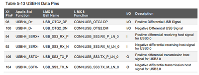

We are developing a product using your i.mx8qm and Linux. This is already our custom board.
We now want to run the serial downloader from USB3.
We have successfully serial download mode using the USB OTG1 port (it is a USB 2.0 port). However, serial download mode using the USB3 port is not possible. Your advice please.
We have allocated USB_SS3 and USB_OTG2 ports as Type C connectors. This USB_OTG2 port is not used as an OTG port, only as a host. The Type C controller is the power source, but the data is set to DRP (It's primary setting is the host. ).
When using USB_OTG1, the serial download mode is successful, so the boot mode should switch correctly.
Why can't I use serial download mode with USB_SS3? Are there any additional settings I am missing?
PC is Win10. Do I need any additional device drivers for the USB port (Type C port) to which I connect the serial download?

And I don't know if there is a problem with the Type C controller's DRP settings or with the serial download mode, but it doesn't seem to appear on the Device Manager when the Type C is connected to the PC.

However, we debugged the type-C controller and found that our custom board was still in host (DFP) and not switched to device (UFP).
Also this is a new question, in serial download mode, is there a file that defines the CPU configuration like the device tree? If so, where is it located? Also, is USB3 defined to work in serial download mode as an initial value?

Our CPU is an i.mx8QM, but we are using a Tradex Apalis computer module, and the schematic of the wiring to the CPU is not published. However, according to the Tradex documentation, the following USB3 signals connect directly to the CPU.
Does this meet your requirements? Do you also need schematics for Type C connectors, Type C controllers, and SSTX/SSRX multiplexers? They are working fine as USB devices (DFP). I think no problem with the connectors and peripheral circuit.

Please try to set the TPS65987 to UFP mode.

I have configured the UFP but the type C controller does not switch to the UFP. I am checking with TI and debugging the type C controller.
