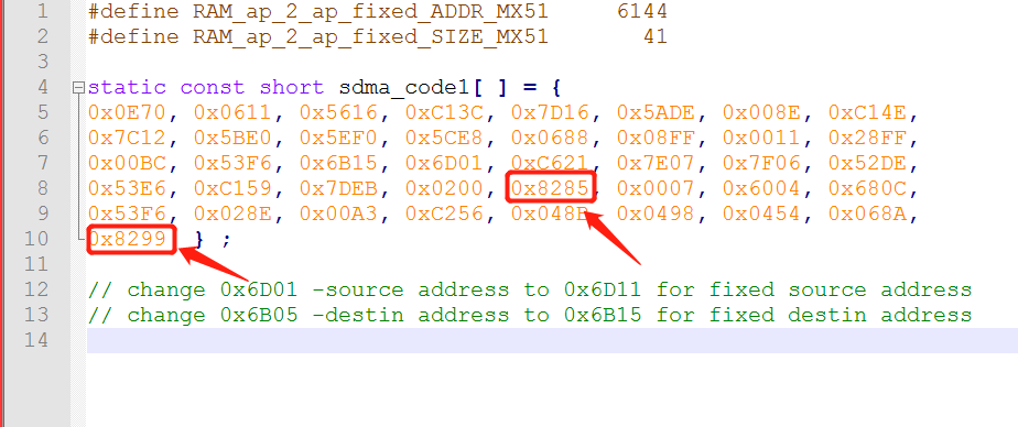

Is these two words need change to RAM absolute address?
