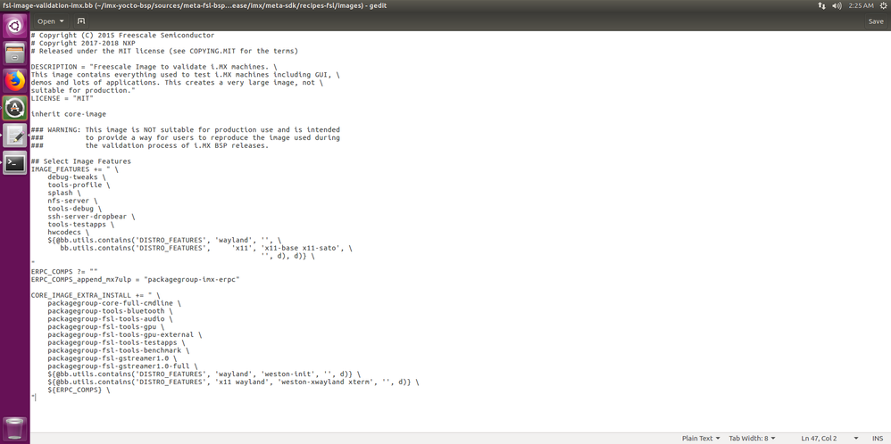

I would like to disable the gstreamer in NXP-BPS for iMX8M Mini EVK for some test reasons. How can I do This?
I removed "packagegroup-fsl-gstreamer1.0-full" and "packagegroup-fsl-gstreamer1.0" from the CORE_IMAGE_EXTRA_INSTALL list, but it still tries to build the gstreamer.

Could you tell us which version BSP are you using? You can refer to the thread https://community.nxp.com/message/1071170 , I am working on it for you , when I get the method I will tell you as soon as possible.

thank you for your response. I'm using sumo-4.14.98-2.0.0_ga.
The main reason, why I wanted to disable the gstreamer was regarding some build issus, which are solved now.
But anyway I'm interested in how to disable it.

You can also try by adding below line in local.conf:
BAD_RECOMMENDATIONS = "gstreamer gstreamer1.0"
It will not install gstreamer, however it will also give you indication in form of error regarding which other packages needs gstreamer.

Rita_Wang
Hi Elmar,
You can try to remove the "packagegroup-fsl-gstreamer1.0-full" and "packagegroup-fsl-gstreamer1.0" from the below file,disable gstreamer compile.PNG
We also will test on our board.
