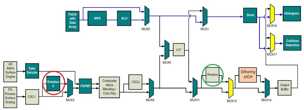

I am using an iMX6ULL.  The driver (drivers/dma/pxp/pxp_dma_v3.c) for PXP defaults to performing the rotation at the output when rotation is requested.  That is, it sets the ROTATE0 in PXP_CTRL instead of ROTATE1.  I wish to perform the rotation on just the input.  This is because I wish to use an alpha layer and don't want that rotated (just want PS rotated).
I have modified the driver to set ROTATE1 instead but the output is not correct.
In order to demonstrate the problem, I created a simple and small input buffer.  It is 16 x 16 pixels of 32 bits each (unpacked 24 bit RGB).  I set the red value to 0xFF and the green value to 0x00.  For the blue value, I set it to the row number so that I can see what PXP has done with the data during rotation:

I ask for an output which is 32 x 32 pixels.  With the original rotation (ROTATE0, rotation at output) all appears normal:

That is not the case with input rotation (ROTATE1) though
Output:

In this small 16x16 example, I'm seeing all zeros where the output data should be.  In a larger example, the output data is nonzero in places, but not at all like the input image.

Besides differences in virtual address, the difference is in PXP_CTRL:
PXP_CTRL   0x0f010103 -> 0x0f011003   (set ROTATE1 instead of ROTATE0)
So how can I rotate just the input (PS) and not output (soon to be PS + AS)?

Was found a bug on PXP IP from i.MX6ULL. The rotation block 2 can't perform rotation if resize or flip is also made. In these cases the image must be passed twice on PXP and perform one operation each time. If Rotation2 is enabled and rotation/flip are also made, the output will be a garbage.
The Linux driver will always switch to Rotation1 to make the rotation.

I received information from the 1039882 thread that I referenced.  Unfortunately, it didn't help.  It was about getting rotation working in the SDK.  Rotation is already working in Linux, just not at the location in the pipeline that I need it to.
Some more information:  The 6ULL RM shows the pipeline stages
I want to rotate at the stage circled in red.  It works when rotation is done at the stage circled in green.
The Linux driver always enables rotation at both locations (ENABLE_ROTATEn bits in PXP_HW_PXP_CTRLn) whether the image is to be rotated or not.  In order to have the image actually rotated, it sets the rotation angle to a non-zero value (ROTATE1 or ROTATE0 in PXP_HW_PXP_CTRLn) and sets the muxes (MUX3/MUX12) to transfer the rotated image down the pipeline.  In the non-rotate case, it sets the rotation angle to zero and sets the muxes to use the line that bypasses the rotation blocks.
I have found that anytime a non-zero value is used for ROTATE1 (corresponding to the circled Rotation 2 block), the output is all zeros.  That is the case even if MUX3 is set to ignore the output of the Rotation 2 block (use the output of CSC1 instead).
In terms of register settings, I leave PXP_HW_PXP_DATA_PATH_CTRL0n set to 0xDD7DFF3F (MUX3 selects CSC1).
PXP_HW_PXP_CTRLn = 0x0F010003 works
PXP_HW_PXP_CTRLn = 0x0F011003 fails
the difference being the rotation angle in the bypassed Rotation 2 block.

It's difficult to test the Rotation 1 on current kernel driver because it selects the rotation block automaticaly and Rotation 1 is used only in very specific cases. I wasn't able to find a demo/example code that selects Rotatation 1.
I changed the kernel driver to force the usage of Rotation 1 and got the same result of the thread above.
In the register log from customer, the MUX3 register is not printed. Coul you tell us, to set MUX3 and print the register PXP_HW_PXP_DATA_PATH_CTRL0.

That doesn't look like it addresses my question.  First, it's not clear from the response that the person used PXP to do the rotation at all.  They just talk about copying between buffers periodically with a "rotation calculation".
To be clear, getting the PXP to do rotation is not an issue.  That's supported in the Linux driver.
However, there are two places where rotation can be performed by PXP.  One (default in the Linux driver) works.  One doesn't work.  I need to use the one that doesn't work so that only the input (PS) is rotation, not the output (which will include both PS and AS).  I expand on that more in my original question.
