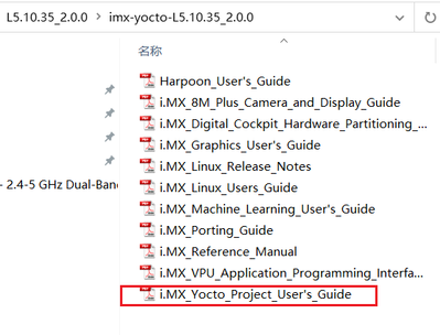

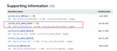

weidong_sun
1. downloading linux documents
https://www.nxp.com/design/software/embedded-software/i-mx-software/embedded-linux-for-i-mx-applicat...
2. decompressing it.
3. Getting / compiling linux source code ( u-boot/kernel/rootfs)
According to i.MX_Yocto_Project_User's_Guide.pdf,  download yocto bsp and compile it.
Have a good day!
weidong
