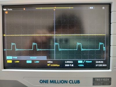

We'd plan to use GPIO4 for data transfer(i.MX8P dual core) . Thus we gave a test of the GPIO speed.
M7 part test.
//skipping the iomux setting and pin setting
while (i<100 000 000)
     //read
     GPIO_PinRead(GPIO4,0);
     //pulling high
     GPIO_PinWrite(GPIO4,18,1);
     //pulling low
     GPIO_PinWrite(GPIO4,18,0);
      i++;
It cost 33 s, totally, the speed is far behind the IPG_clk we set, 133Mhz.
As the image show, every high last 65 ns, every repeat last 330 ns.
If the read cost 2 clock loop, the clock time is 30 ns, which is 33Mhz, far behind the 133 hHz in reference Manual.

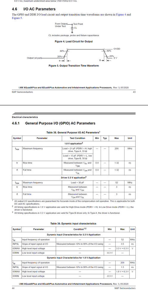

gidame
The person asking the question doesn't know what information to provide, such as pad settings and voltage. The person answering the question is not familiar with imx at all.
The datasheets of all imx chips have descriptions of IO AC characteristics.
