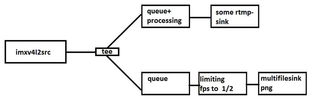

Hi everyone,
I'm working on a project using the i.MX6 to send out two different video/image signals using GStreamer.
The basic idea of the project/pipe is this:
My pipe-construct looks like this:
gst-launch-1.0 __SOURCE__ ! tee name=t \
t. ! videorate drop-only=true ! capsfilter name=frame_rate ! imxvideoconvert_ipu ! queue max-size-buffers=1 leaky=2 name=q ! vpuenc_h264 ! flvmux ! rtmpsink_rlm #someworkingrtmpsink# \
t. ! queue !  __FRAMERATE__ ! videoscale sharpen=1 sharpness=1.5 ! pngenc compression-level=1 !  multifilesink max-files=3 location=/tmp/SinkPic%05d.png

Now when using the desired "__SOURCE__" = "imxv4l2src" thats what happens for above framerate settings:
__FRAMERATE__=   " videorate drop-only=true max-rate= 10 "  works fine
__FRAMERATE__=   " videorate drop-only=true max-rate= 1 " aka close to what I desire gives the following error:
0:00:02.052936041  1232   0x6a5090 LOG                videorate gstvideorate.c:653:gst_video_rate_flush_prev:<videorate0> old is best, dup, pushing buffer outgoing ts 0:00:00.400000000
0:00:02.146247057  1232   0x6a5090 ERROR                imxv4l2 gstimxv4l2.c:1563:gst_imx_v4l2_find_buffer: Can't find the buffer 0x45100000.
0:00:02.146391726  1232   0x6a5090 ERROR             imxv4l2src gstimxv4l2src.c:631:gst_imx_v4l2src_acquire_buffer:<source> Queue buffer 0x74b06b68 failed.
0:00:02.146513394  1232   0x6a5090 WARN                 basesrc gstbasesrc.c:2943:gst_base_src_loop:<source> error: Internal data flow error.

In the first case  (framerate = 10 ) I can detect that TOP CPU-usage for the pipe is very high and actually there are way less pngs created per second than the defined 10, so my guess is that once my fps defined are below the maximum pngs/sec the CPU is capable of the above error occurs.
__FRAMERATE__=   " videorate drop-only=true ! video/x-raw,framerate=X " [X>1] same as with the videotestsrc
__FRAMERATE__=   " videorate drop-only=true ! video/x-raw,framerate=1/2 " works perfectly for about 2-20 seconds, when finally it crashes with the following

Additionally when using the above pipe without the queue for the png-tee-branch the pngs get created every 2 seconds as they should, the pipe doesn't break, but
the live-image is stuttering exactly every 2 seconds which is intolerable for the application.
My question would be if there is a known issue concerning the imxv4l2src in connection with queues and framerate-changes, or if I'm just missing something within my pipe.
I'm grateful for every help and hoping that my attached logs help finding the issue.

what yocto version do you use? I suggest that you can upgrade to the latest version, which fix many bugs from old version, then test it, if has the same issue, pls let me know it.
