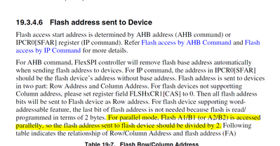

Thank you so much for your reply It was pretty helpful. While implementing Parallel Flash Mode, we observed a few things as mentioned below:
1. As per the reference manual, we have to send the flash address divided by two for erase, program, and read operations to perform in parallel mode. PFB reference manual snapshot.
But, we observed the FSPI is not working as expected as per the below highlighted note. Instead, it was working fine when passing the address without dividing by two which seems the module itself taking care of the address division. Can you confirm the address to be passed in parallel mode?
2. We are enabling 4 Byte addressing mode during initialization and reading the Flag Status Register from the flash chips in parallel mode and observed the 4-Byte addressing bit is not getting set, whereas in the individual mode, it is set as expected. Can you please provide your input on this behavior when FSPI is reading flag status in parallel mode?

1) Yes, The module itself manages the addressing according to the individual or parallel mode of Flexspi.

  Thank you for your response and confirmation. for point 1 It would be good if the module itself is doing the division.

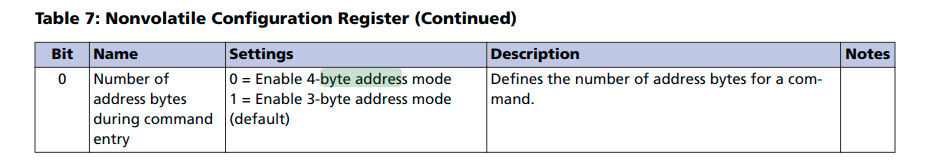

and for point number 2, Below are the steps for the observation in parallel mode:
  1. Initialize the FSPI in parallel mode and populate the LUT.
  2. Trigger IP-based command (parallel mode) to enable 4-byte address mode(as it will send the same command to both flashes).
  3. Trigger IP-based command (parallel mode) to read the flag status register to verify the addressing bit is set for both flash chips in the receive FIFO. PFB snapshot for register bit.
The same steps are repeated by initializing in the individual mode and observed the addressing bit is set on the flash device. But, In parallel mode we observed the bit is not set on both flash chips. Hope, it will helps you to investigate further.

Sorry, I was unable to respond as the NXP portal is under maintenance. We are using the 0xB7 command for enabling the 4-Byte address mode and sending it to both the flash devices by enabling parallel mode

The command is correct for setting 4-byte addressing.
For the bits you are reading, it is mentioned that "All bits are volatile and are reset to zero on power-up." Please check bit 0 from Table 7: Nonvolatile Configuration Register from the datasheet to confirm the number of address bytes for a command.
further, confirm if you were able to perform the operation with 4-byte addressing mode with success or not.
i.e
1)READ MEMORY Operations with 4-Byte Address.
2)ERASE Operations with 4-Byte Address etc.
