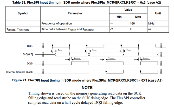

According to: https://www.nxp.com/docs/en/data-sheet/IMXRT1160XEC.pdf,
When defining the FlexSPIn_MCR0[RXCLKSRC] = 0x3,
the FlexSPI controller samples read data on a half delayes DQS falling edge.

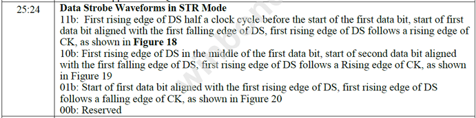

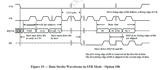

According to JEDEC SFDP for STR / SDR the flash NOR with DQS/DS (data strobe) can work mode (10b):
first rising edge of DS in the middle of the first data bit, start of second data bit aligned with the first falling edge of DS, first rising edge of DS follows a Rising edge of CK.(CLK/SCK)
Please advised how FlexSPI can also support DQS STR/SDR flash NOR with mode 10b, as described above, as current implementation cause the read to skip first DQS/DS/RWDS clock signal.

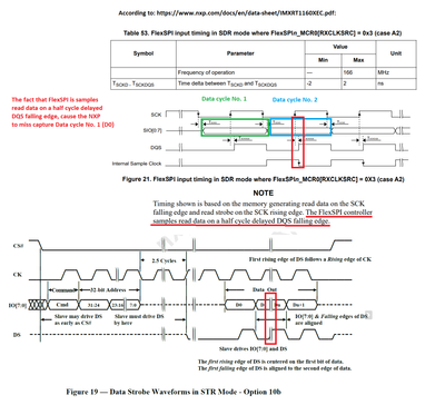

DanielNis
Hi Jing,
Please see the following picture to clearify the issue:
Daniel.N
