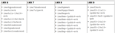

I suggest you check your build process directly with Debix since our BSP only has our EVKs machines.
Here more information:
Best regards.
