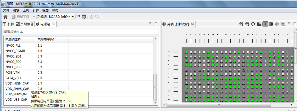

1226230646
Hi Kanou
     I got a new problem about VDD_SNVS. I use i.MX Pins Tool v4.1 to set pins,about “Power group” ,the VDD_SNVS_CAP Recommended voltage range is{2.8-3.3} .But ,in fact,as you said LDO_SNVS  is 1.1V(I check my bord is 0.99V).So,my question is :Why is the reference value exceed the actual value so much.What is wrong!pastedImage_1.png

kanoumamoru
Hi Yuri,
VDDSOC_IN is devided to 2 path LDO_PU and LDO_SOC.
i.e. LDO_PU is used for GPU and VPU, LDO_SOC is used for internal SOC, HDMI_VP, SATA_VP, PCIE_VP,
and PCIEVPTX.
I want to know the max current ratio of LDO_PU and LDO_SOC because we can't mesure each internal current.
In my feeling I guess that
LDO_PU vs. LDO_SOC is  8:2.
Please let me know if you have any informations and comments.
Its information help our PCB power-rail pattern (mainly line-width) design.
Kanou
