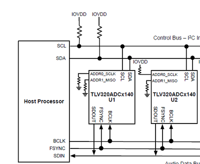

Hello
I am working on a custom design: the host IMX8MM - SAI2  is the audio master for two ADC codecs (TDM) --> my target is to capture 8 MIC ( 4 from each ).
I couldn't find any example for such dai-link: 2 * ADC ( codec ) salves for the same host.
Consider below  dai description :

Please advise how is possible to describe such dai-link in ALSA .
Moran.
