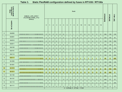

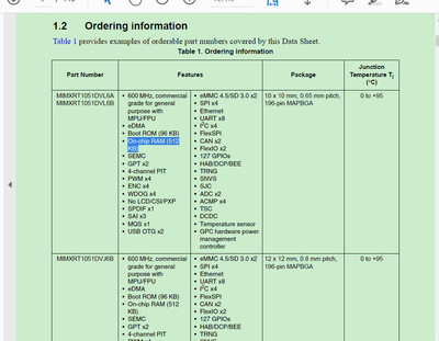

     RT1051 have 512KB internal RAM, not 256KB.
For the flexRAM configuration, you can refer to the AN12077:
https://www.nxp.com/docs/en/application-note/AN12077.pdf
The yellow one can't be selected.
 0kB OCRAM is also not be used, as Consider at least 64 KB for the OCRAM configuration because the ROM code requires this portion of RAM for execution (stack/static data).
So, please refer to the AN and choose the correct reallocate again.
