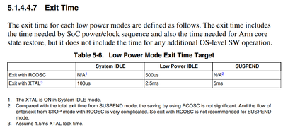

Hello
Please refer the LPM exit conditions:
but is there a way to externally determine which of the CPU's RTC clocks is running?
--> BIT(0) of XTALOSC_OSC_32Kn
