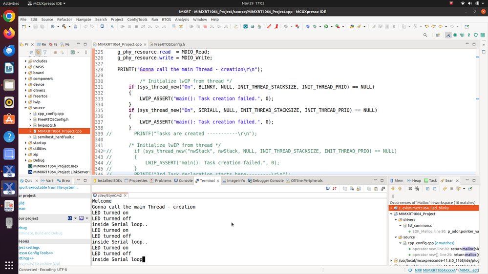

Hi fellas,
I've created a sample c++ project - with lwip+freeRTOS - for two threads. It works fine as shown below:
When I tried to add 3rd thread - the build was successful - yet the none of the threads are being scheduled.image.pngimage.png
To be very specific, the 3rd task creation itself failed. Hence, I think scheduler is not even called. Why it happens so?
The threads are as follows,

Omar_Anguiano
Hello
I hope you are well.
Is the same issue present if you increase the stack size for the task? Which status is returning sys_thread_new()?
Omar
