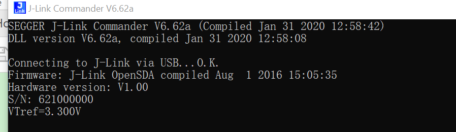

  Seems your log is not complete, do you have the first log, whether the it contains the JTAG voltage?
 Something link this:
  Please make sure you connect to the correct interface.
  When you change the SWD interface, you need to power off the board, connect the SWD debugger, then power on it again, don't do the hot connection.
  If all the item is correct, you can try this JLINK commander: unlock kinetis
  Whether you can do the flash mass erase or not? then try to connect the K20 chip again, please note, it need to be powered.

Found SW-DP with ID 0x2BA01477
DPIDR: 0x2BA01477
Scanning AP map to find all available APs
AP[2]: Stopped AP scan as end of AP map has been reached
AP[0]: AHB-AP (IDR: 0x24770011)
AP[1]: JTAG-AP (IDR: 0x001C0000)
Iterating through AP map to find AHB-AP to use
AP[0]: Skipped. Could not read CPUID register
AP[1]: Skipped. Not an AHB-AP
****** Error: Could not find core in Coresight setup
Cannot connect to target.
J-Link>unlock Kinetis
Found SWD-DP with ID 0x2BA01477
Unlocking device...Unlock via debug port is disabled. Unlock failed.
Timeout while unlocking device.
J-Link>
Thank you,
Igor
12,990 Views
kerryzhou
Hi igor brusentsev,
  This board result is not good.
  From your test result, your K20 Mass erase is disabled, and it is also secured, so the security level is the highest, you can't unlock it. Maybe you can apply the same K20 sample chip, and replace the on board K20 chip.
  BTW, do you try to connect your on board K66, whether it can use the external debugger to download the code, it you can, you also can use the external debugger directly.
Wish it helps you!
If you still have issues about it, please kindly let me know.
Kerry
12,990 Views
brusentsev
Hi Kerry. I did try but no success.
Thank you for help.
Igor
12,990 Views
kerryzhou
Hi igor brusentsev
  What do you mean, you mean even you change the on board K20 chip, still have not success?
  Still can't find the ARM core? Please check the K20 power, whether K20 chip have power or not?
Wish it helps you!
Kerry
12,933 Views
brusentsev
Hi Kerry.
We had to purchase more boards. All new boards except one I updated with proper bootloader. Now I have 2 bricked boards. One is from the message above (we called it #2 in previous messages)  - I can't connect not via J9 and not via J10.
The other bricked board(lets name it #3rd) - I would not be able to track how exactly it got bricked.
I can program firmware but once I connect the JTAG to program bootloader - voltage shows 0v (as oppose to 3.3 on the working board).
Connecting to J-Link via USB...O.K.
Firmware: J-Link EDU Mini V1 compiled Sep 28 2020 16:25:21
Hardware version: V1.00
S/N: 801024703
License(s): FlashBP, GDB
VTref=0.000V
Please advise if I can restore any of those boards.
Thank you.
Igor
