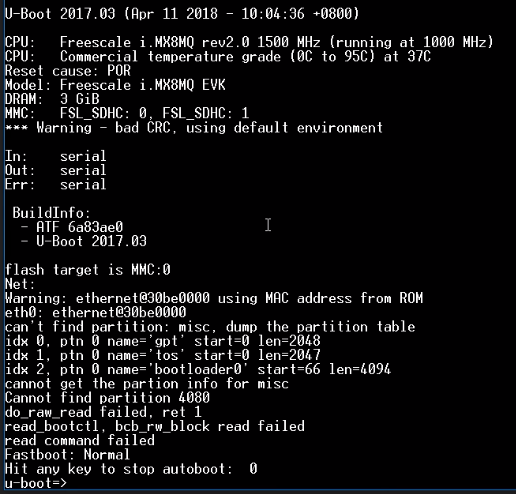

  • When changed the boot mode switches to boot from eMMC with OFF OFF ON OFF (for SW 801 DIP switches 1 - 4 respectively) we are seeing logs of old version of u-boot (U-Boot 2017.03 (Apr 11 2018 - 10:04:36 +0800)) which probably had come with the board to boot the Android from eMMC. This behavior is same even after clearing the whole of SPI-NOR (/dev/mtd0) & eMMC memories. Not sure from where we are getting the logs of older u-boot as this mode should boot from SPI-NOR which is completely empty.
Got below logs for the older version of u-boot:

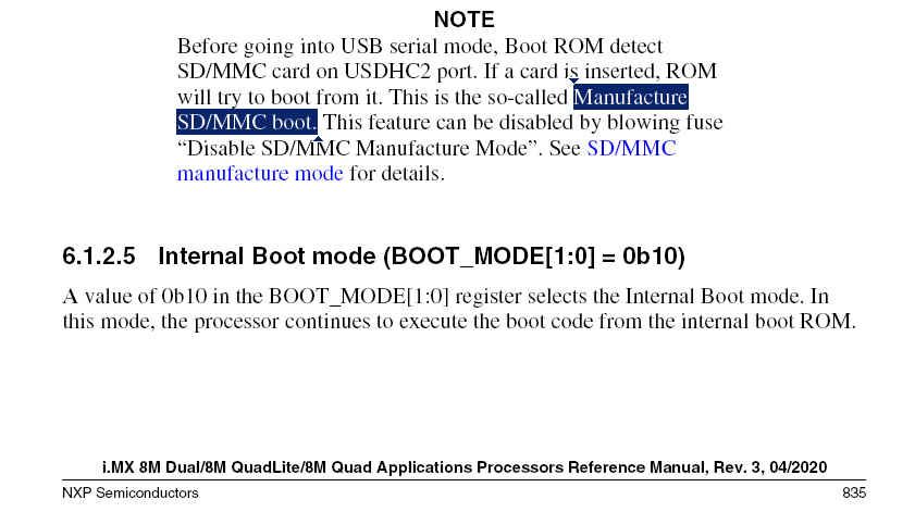

reason may be that new image was not properly programmed, one can try to
program it with uuu tool
GitHub - NXPmicro/mfgtools: Freescale/NXP I.MX Chip image deploy tools.
use guidelines provided in i.MX Linux User’s Guide
Please pay attention to Manufacture Mode
igor

I did not program the SPI-NOR flash memory with any image. I cleared the SPI-NOR flash memory and set the target boot mode switches to boot from eMMC. I was expecting the board not to boot as there is no image inside the SPI-NOR flash.
Note: I programmed the custom image inside the SD card and the board booted up well, when the boot mode switches are set to boot from SD.
When I set the boot mode switches to boot from eMMC an older version of u-boot (U-Boot 2017.03) came up. I'm very confused how come the board is booting at all as the SPI-NOR flash memory & the eMMC are completely zeros and the SD card has latest version of u-boot (U-Boot 2018.03-imx_v2018.03), please add clarity.
Is there some other memory the board falls back if there is no image in the SPI-NOR flash in the eMMC boot mode?
