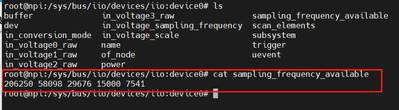

We want to use ADC for fixed-frequency downsampling, and we want to use IIO buffer interface to meet our requirements. After the CONFIG_IIO_SYSFS_TRIGGER=y is enabled in the kernel configuration, the corresponding interface appears. As shown in the picture below:
After our tests, the cache is now available, and the maximum available sampling frequency provided by the system is 206250, as shown in the figure below:

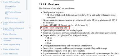

But now we need a higher sampling frequency. Through reading the manual, we know that the maximum sampling frequency of the development board is 1MHZ. How should we set this?

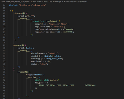

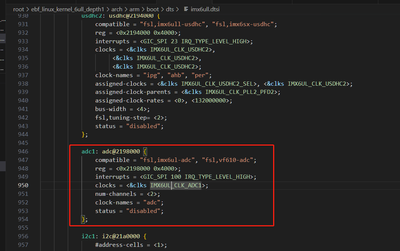

 The current device tree configuration is as follows:
