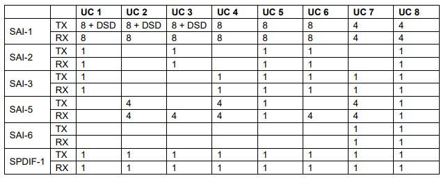

The SAI-1/2/3/5/6 and SPDIF-1 share GPIO pads on the chip through IOMUX. Common use cases supported by the audio interfaces are listed in the table below (many other configurations are possible). The number is the data lanes supported.

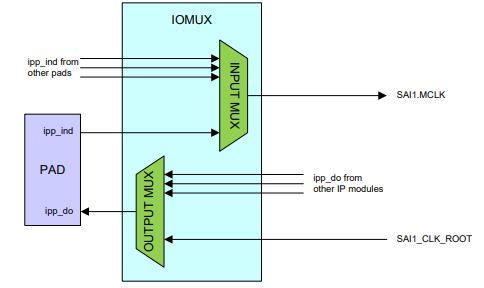

For the MCLK pin on each SAI module, it can be configured as either input or output. When configured as output, the SAI_CLK_ROOT from CCM will be routed to the pad output. When configured as input, the external input to the pad will be routed to SAI.MCLK, which can be used as master clock for SAI. Below is the diagram showing the both input/output options, by using SAI1 as the example.

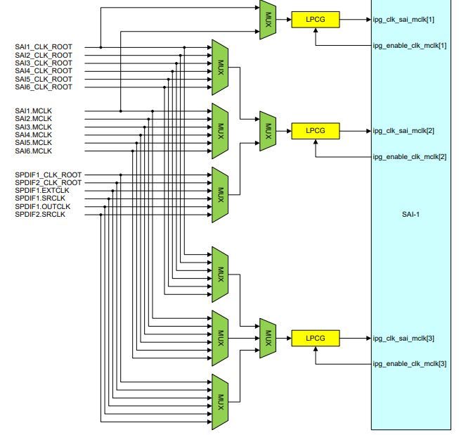

Each SAI module supports up to 3 master clock inputs. The TX and RX sub-module inside each SAI can independently select one of the clock inputs as its master clock. This allows TX and RX of one SAI to run from different clock source. The master clock inputs have following options:
- SAI.MCLK[1] can be selected from SAI_CLK_ROOT from CCM or SAI.MCLK from IOMUX. This is the most straight-forward clock routing in which SAI only use its own clock source from CCM or IO pad.
- SAI.MCLK[2] can be selected from following clock sources:
      Any of the SAI_CLK_ROOT from CCM;
      Any of the SAI.MCLK from IOMUX;
      Other clock sources from SPIDF;
- SAI.MCLK[3] has exact same clock source options as SAI.MCLK[2]. This allows both TX and RX can have access to all the options without any dependency between each other.
The clock options for master clock on SAI are shown in the diagram blow, by using SAI-1 as an example.
The options on MCLK[1] is also available on MCLK[2] and MCLK[3]. The reason to keep this options is to provide the similar SAI clock structure as i.MX6/i.MX7 processors. The configuration of the MUX for master clock are controlled by IOMUXC_GPR registers. They should be configured before SAI clock is enabled to avoid glitches on the clock.

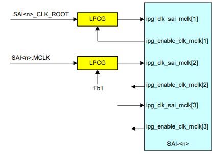

Note: Because those MUX on clocks are missed during the design, the actual implementation in the silicon is simplified as shown in the following diagram.

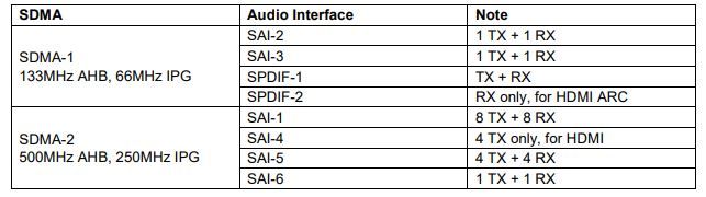

All the SAI and SPDIF instances have SDMA support. In order to meet the audio data rate, two SDMA modules are used.
Because the SAI-2/3 and SPDIF-1/2 do not require high data throughput, they are assigned to SDMA-1, shared with other peripherals such as UART/SPI. SAI-1/4/5/6 need to support high sample rate & multichannel audio, they are assigned to SDMA-2, which is a dedicated SDMA engine for audio. The SDMA-2 frequency is increased to 500/250 instead of 133/66 to make sure it has enough throughput.
