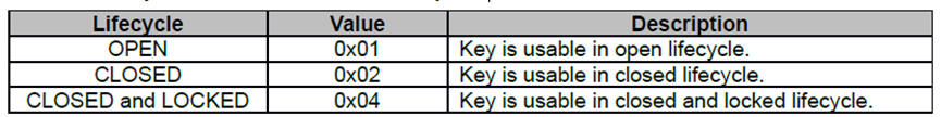

2. Key has lifecycle attribute. This attribute defines in which device lifecycle the key is usable.
This attribute is set at key creation operation (generate key, import key, key exchange …). Before executing a key depending cryptographic or data storage (export option) operation the key lifecycle is compared with the current device lifecycle. Operation is executed only if the key lifecycle includes the current device lifecycle.
When mentioned in the API command message description, the key lifecycle could be set to the current device lifecycle if the value is set to 0x0.
Lifecycle values are encoded as bitfield. Multiple values could be set. The key could be used in several lifecycles.

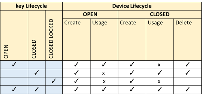

Tested cases:
The key lifecycle attribute is verified during the key usage, not when the key is created.
If the key operation doesn’t match device lifecycle, it will report 0xe29 - The key is not usable in the current lifecycle.
 Please see attached hsm_generate_key.c / hsm_generate_key_signature.c  for reference.

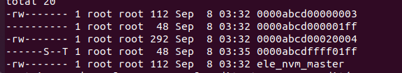

One assumption based on tests: It looks that each key group has its own SW counter, which may record update time of this key group.
This is the test on i.MX93: If we delete the key group #2 file 0000abcd00020004 only from NVM manually, then we cannot create key of group #2 again, but we can create key of group #1.
The process might be: Try to create key in group #2 -> checked the counter value is not 0 -> try to import the chunk from NVM -> fail because the chunk is deleted.
Each key group has its own counter, so key group #1 is not affected.
