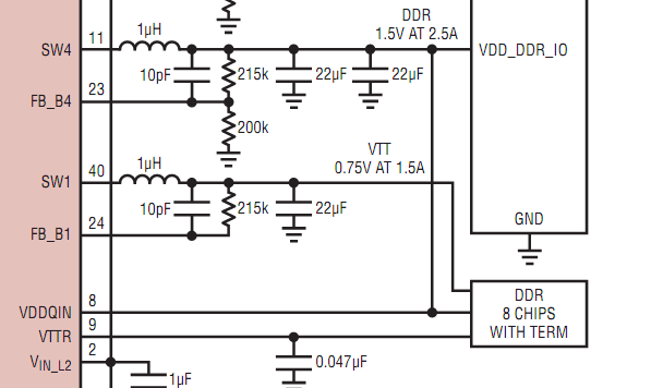

We have gone through the PMIC  for i.MX6 and it looks very good for our application.
I have the following doubts to get clarified.
1. We are going to interface 4 DDR3 (x16 bit) chips to i.MX6.
DDR3 requires the following power supplies
1. 1.5V
2. 0.75V
As shown below, 1.5V is supplied by SW4 of LTC3676 and 0.75V is supplied by SW1.
From the datasheet, 1.5V of SW4 is connected to VDD & VDDQ of DDR3. 1.5V of SW4 is also connected to VDDQIN to generate 0.75V.
But VTTR (pin 9 of LTC3676) is connected to which pin of DDR3 memory?

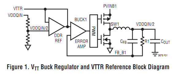

Moreover I do not understand the following block diagram. VTTR is connected to both input and output of comparator. How it works?
Can you please help me in understanding this.
Karthik R

Hello Karthik,
You have the right initial understanding of powering DDR3 with LTC3676-1. Your questions are mostly on VTTR.
VTTR of LTC3676-1 is an output that buffers ½ VDDQIN. The block diagram shows this buffer as an opamp in unity gain feedback where OUT (VREF) is also tied directly to the negative input of the amplifier forcing it to track the amplifier V+ input which comes from a precision resistor divider which creates ½ x VDDQIN.
For connections to the DDR3 chips here is what I can say.
Most DDR3 chips I am familiar with have VREF pins. As an example, I am looking at DDR3 from Micron, part# MT41J256M16. These devices have pins VREFCA (for control and address) and VREFCQ (for Data) voltage references. The pins are described on Page 20 of that datasheet, with electrical spec requirements shown on page 46. Both VREF pins should track VDD x .5 to within 1% (+/- 15mV).
One point that our simplified block diagrams do not show properly is that VTT does not usually connect to the DDR3 chips. It is used as the termination voltage and is connected only to termination resistors. VTT still must accurately track ½ VDDQ as the LTC3676-1 provides.
I hope this helps.
Jeff Marvin
Burlington Design Center Manager
Linear Technology
